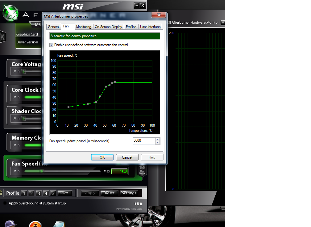

Heres what I do , with my single card. MSI afterburner allows you to plot your own
fan curve easily. You just plot points temp/vs fan speed.
Ramp up your fan speeds starting around 60f to a higher speed than they currently are.
Unlike the curve I'm showing there, as the temps aproach 80, have the fans at 80, or higher than they are now.
I don't think much over 90% fan speed is any more efficient at moving air than a 100, but I could be wrong.
