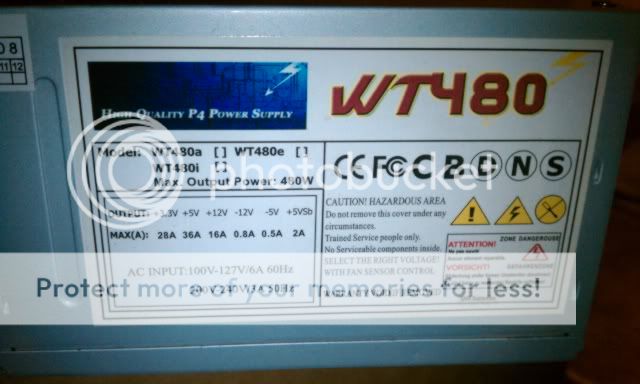

not sure about power supply it says on it: "high quality p4 power supply" a weird looking symbol and a 480 after it. its max output is also 480.

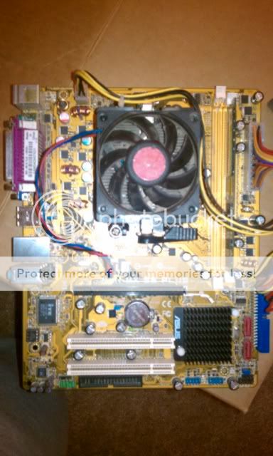

i decided to be a smart ass today and i pulled a tv tuner card out of the pc while it was on. immediately the system turned off and when i went ot power it back on it cranks over for 3 sec then goes dead no beeps lights or anything.
before you say anything i have been reading ever thread in here remotely related to my issue and i have tried all the different suggestions.
cleared the bios cache thing (moved jumper, pulled batt)
set up the mobo on a cardboard box and powered on by shorting the power pins
ensured cpu fan is plugged in and operational, replaced with other fan
switched psu
cant really try another cpu since i dont have a spare one and same with mobo.
the weird thing is if i pull the 12v cord off the mobo it'll power on and stay on however it will not boot or beep or catch on fire or anything.im getting a multimeter tomorrow so i can do some better diagnosing but i am not quite sure how to use it yet.
so if anybody can come up with a suggestion of any sort by all means let me know
here are some pics...might be usefull for whatever reason

I wouldn't be surprised if you've killed it. The motherboard at least.
I once plugged an ISA gameport card into an IBM AT when it was on and that did a similar thing - mine made a nice pop.
You might be able to save the ram/cpu - try testing them in another machine if you can.
You've learnt something though - standard expansion cards are not hot-swappable!

Quick diagnosis from what you've said is dead motherboard. You have likely damaged some of the components on the board with your houdini card removal trick, either created a surge or a short, and it has stopped. The power supply will still spin up as what you've done is likely to be affecting a lower voltage circuit on the board, not big enough numbers to kill the PSU.
What I suggest you do is try the initial steps as jsc has outlined, try testing with a speaker and see if you get any error beep codes etc (which I personally doubt you'll get). Once you've done this and if you get nothing I'd say you can resign yourself to the fact that the board is toast. (RAM slot doesn't matter, it should boot in either slot) The only thing left to do then is test the cpu and ram in another working machine if you have access to one and then either buy another motherboard or start again. To be honest its all pretty old stuff so if initial testing reveals nothing I'd just look for another barebones bundle, you should be able to pick up a cheap dual core and 2gigs of RAM bundle for pennies on Ebay.

ok well im leaning towards the motherboard being dead as well the thing that is bothering me is that the little green led is on once i turn the psu on. also i put a case speaker with it and got no codes whatsoever.
i used another psu i found around the house that was a bit more powerfull (see image below)
last question i have is. what does it mean if the board stays on if i dont plug in the cpu cord from the psu? wouldnt that mean i fried my cpu rather than the board itself ?let me know if you want a video of this process ...
