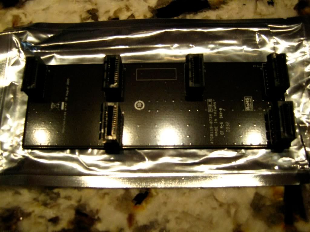

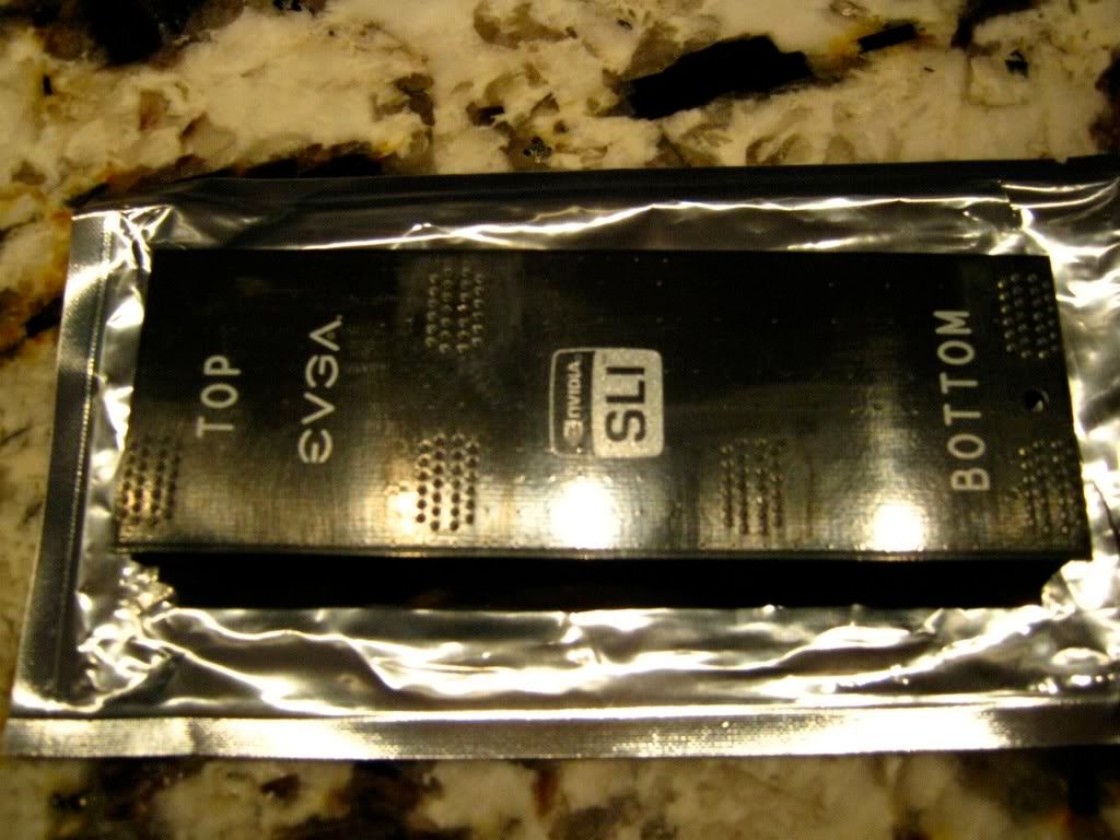

Toms built a 4-way crossfire system in a AMD build series here http://www.tomshardware.com/reviews/amd-enthusiast-cros... , SLI requires the unique connector where all cards are connected, you can google for the picture.
Ok here is the 4 way sli-bridge, its very rare (who does it)
3 way sli
SLI + crossfire bridges are different .
