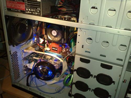

I remember seeing one that was sitting on a heatsink when sometime ago I was looking at CPU cooler and noticed indirectly one that clipped on on the mobo heat sink
similar to that one, only the fan though

It looks like there is a NB fan header just between the PCI-e x1 and PCI-e x16 slots just to the left in that picture above.
I like the specs of that Scythe mini-kaze 40mm fan. You'd probably need some flexible wire to tie it to the heatsink.

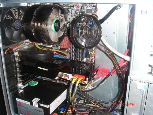

Thanks, all really helped me a lot, I placed a fan on the area temporary and it actually seemed to even help my processor temperatures as now underload max hits 51 Cº and iddle at 43 Cº, as for my video card it dropped to 68 Cº underload, but I'm still seeing the point that Anihilate made as I measured the space between the cards and it's 1cm and 28mm which barely gets any air, so I'm planning of getting two spot fans and place them on a similar matter.
Pointing at the heat pipe and to the fan in the back so it pushed the hot air out.
Pointing to the middle of the cards
Really really thanks a lot, this helped me trough as I was getting worried the max temperature of the CPU is 63Cº and it was almost reaching that, and also hopefully it will help the video card. I'm getting those two spot fans tomorrow.
