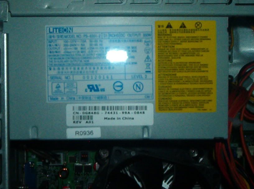

my PSU is 350 watt heres

As for the PSU I can't read that with the blur and the glare but it doesn't matter, your current card really does use slightly more power so there's nothing to worry about. If you'd like to take a look at the numbers yourself you can here;
