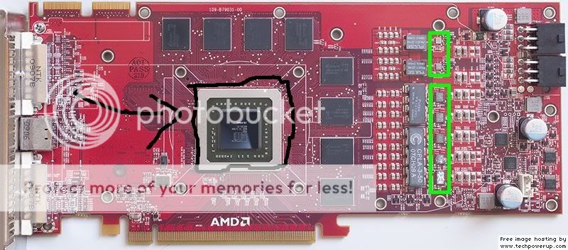

no artifacts from atitool, something is messed up.
You need to look up how to apply and clean compound. With out knowing that much of our advice is pointless. Second take the card out and attempt to clean the dust that is there even if it seams to not be much there. Third make sure all your fans are working properly and if there is an empty space for one get one. Fourth what brand and model is your psu, just saying wattage alone is never enough. I have seen projector lamps that had that wattage rating.
