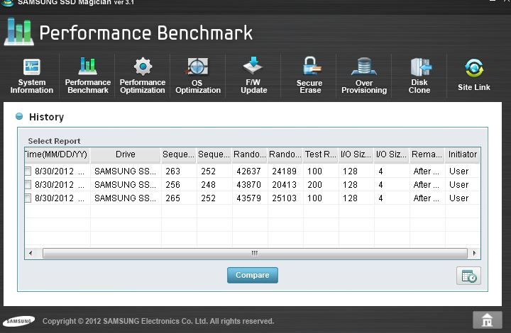

Hi RetiredChief
Got my SSD installed .All working goo(i think so)
Old HHD is on too. Booting from SSD following your guidelines. I did some performance benchmarks and this is the figures I got. Is it acceptable for a SATA II?
I also ended up with having system reserved (E) drive which is 61.8MB free of 99.9MB I suppose it is the famous 100MB thing isn't ?
Link to SSD benchamrks :http://i1119.photobucket.com/albums/k621/nebulaoperator...

Your Link didn't work.
But if you used AS SSD and your overall score is around 500 You are good. Over all score for 830 on sata III is in the 700's I believe.
Boot time (off of SSD) on sata II should be around 20->25 Sec. For sta III it is arround 15 Sec give or take a little. But does depend on Number of/and which programs are in the start up.

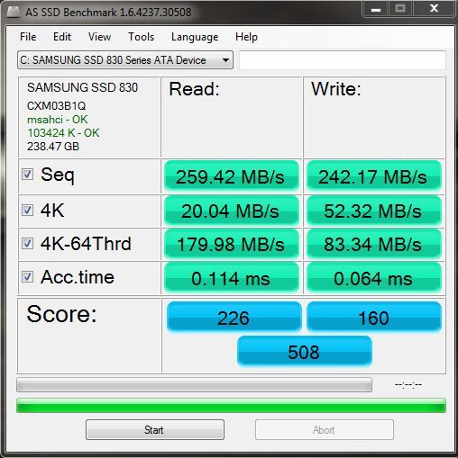

Sorry link looks a bit messy if you copy and paste this one http://i1119.photobucket.com/albums/k621/nebulaoperator... it should work
I will try it again to attach image:
What do you mean AS SSD? I can't really see the score you are talking about.Is it displayed when ,,performance benchmark,, is done on Samsung SSD magician or there is another program to get the score?
I am using SATA II just to remind.
Edit .I know what you mean AS SSD. will download now.
August 31, 2012 7:11:39 PM
here we go. Looks good.
