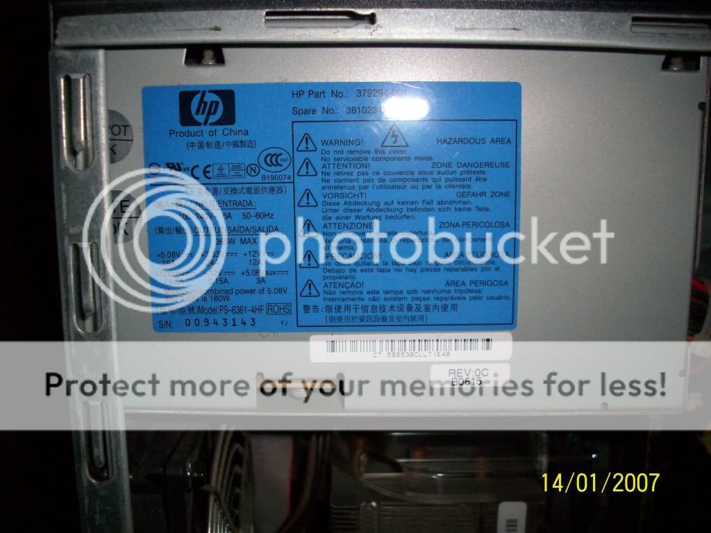

what're the rest of that rig's components?
if priced equally (or the difference in price is roughly 5$),i'd take the gddr4 variation
but then again 12amps on that +12v rails makes me wanna think twice.

Yes it will be fine it takes all its power from the motherboard so doesn't need extra power cables.
