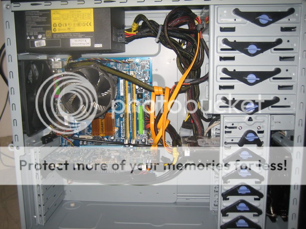

Got the Cooler Master 335 Elite and added the one optional intake fan you suggested COOLER MASTER R4-L2R-20CK-GP 120mm BLUE LED Case Fan (just in blue its 90 CFM and 19 dB-A)
Justwanted to make sure that my front fan is installed correctly: the front fan should be sucking in air and blowing it towards the back of the case while the rear fan sucks the air in the case and pumps it out? Right?
Its 30'C outside today and I am "idling" at 38'C now (instead of 50'C-55'C)
will try out gaming either today or tomorrow and will report back.Here is a pic of the new inside:
Thank you all so much for your help
