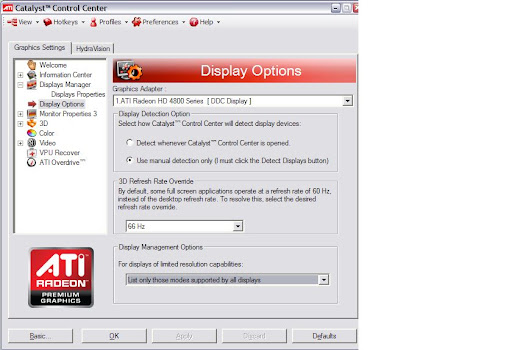

As long As the Monitor Has out putted its Specifications (Lehman's Terms) To the drivers There shouldn't be any flickering or GSOD's
IF this Tab Looks like this in your Catalyst Then Everything is in check (Your Refresh rate should be 60HZ) [:fisshy:5]
