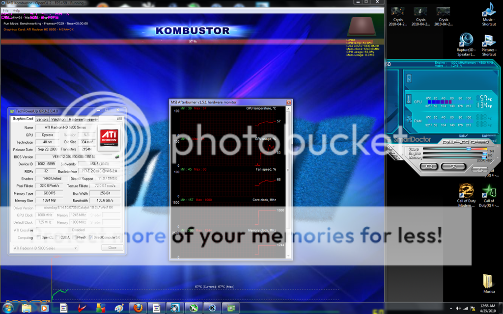

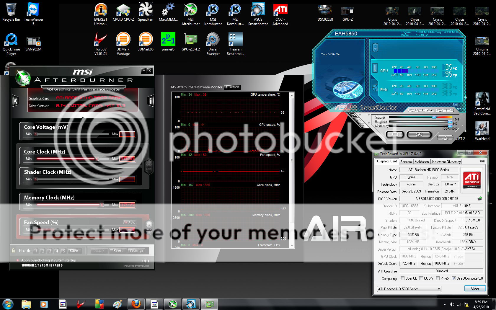

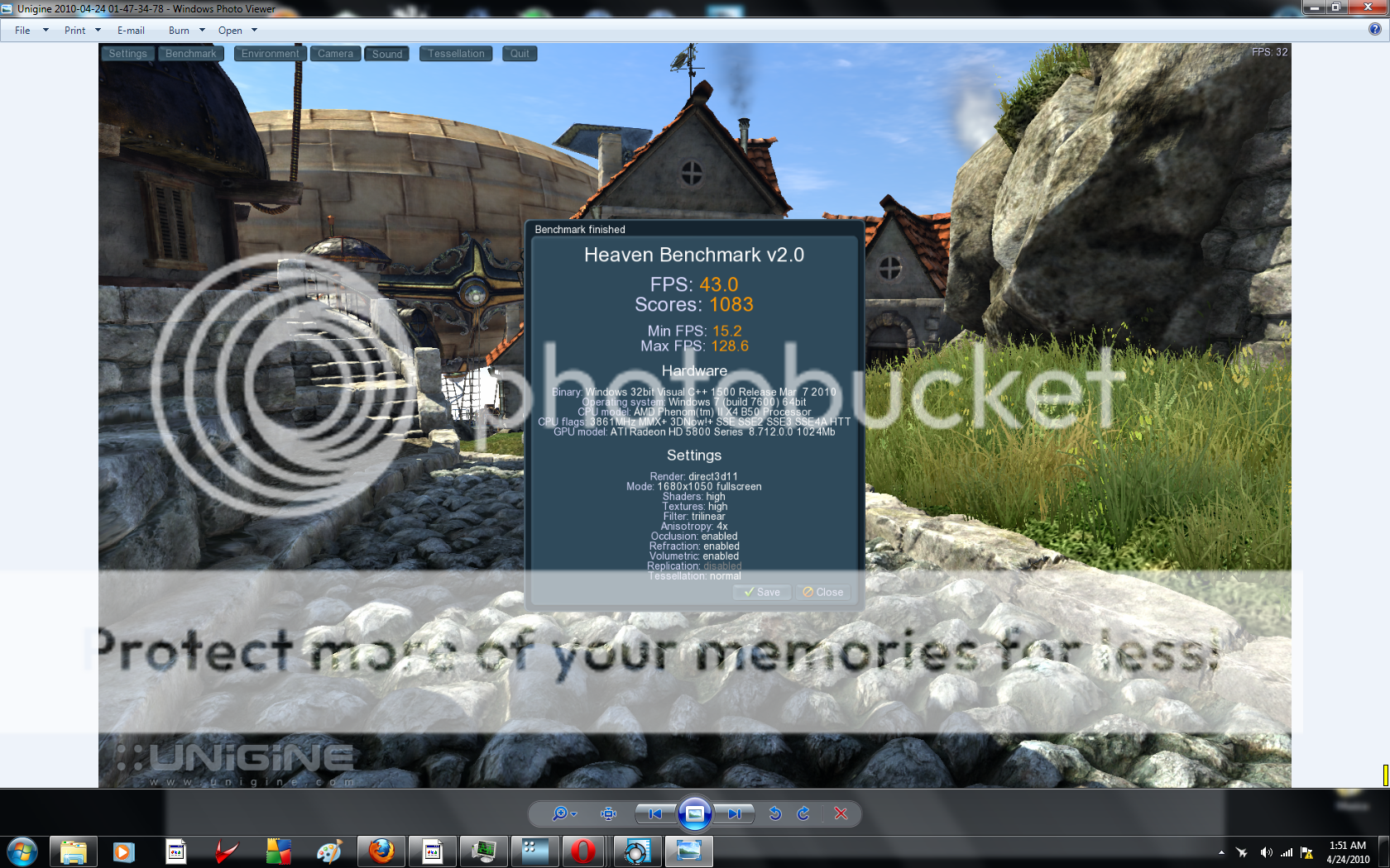

My DirectCU maxes out at 1060/1310 1.28v but since I see no perfromance gain I just leave it at 1000/1250 1.22v with load temps of 68c max unless running kombustor extreme burn-in. Here are some screenies :
IDLE @ 1.2v :
IDLE @ 1.25v :
Quick Bench @ 1.25v :
I cannot locate my extreme-burn-in screenie but it topped out at 79c after 10 minutes @ 1050/1300 1.26v.

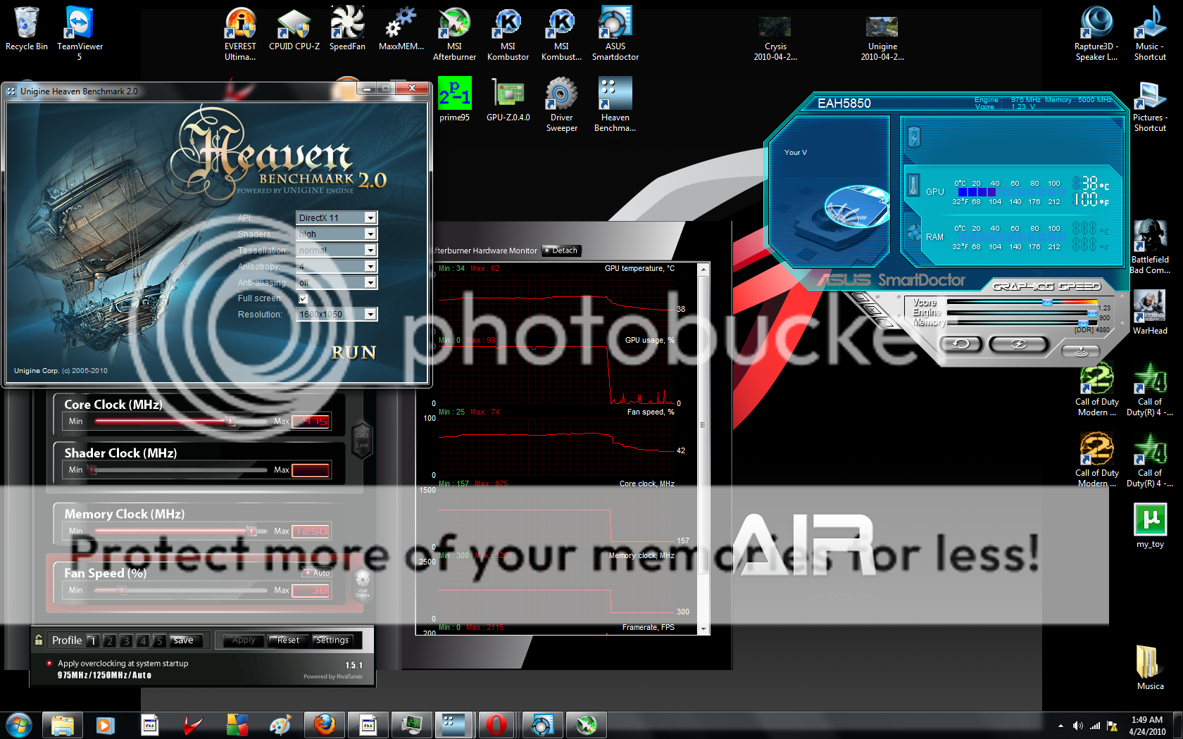

Here is a Heaven Bench @ 975/1250 :
I also re-pasted the cooler with MX-2 and saw an improvement in temps by -2/-3c. The paste that comes with the DirectCu is garbage, when I removed the cooler I found out that the paste was not spread evenly and in-turn gave me an idle temp of 36-37c.

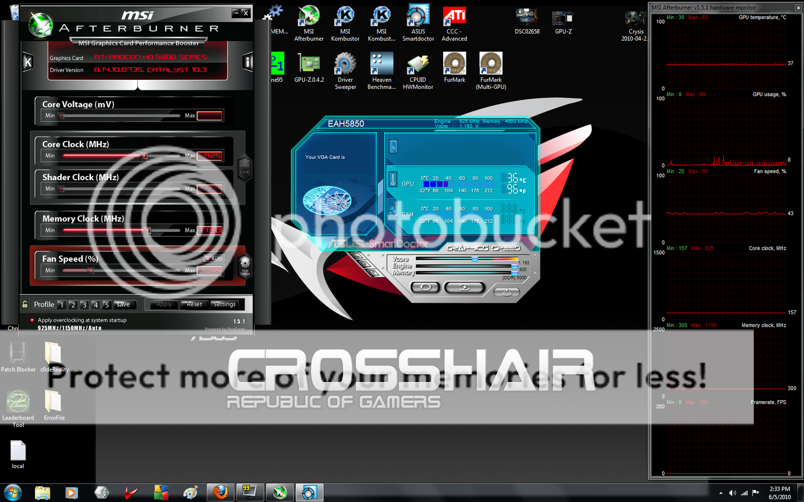

1. When I have afterburner on, the card no longer downclocks when dealing with less graphics intensive processing. Is there a way around this?
2. ASUS SmartDoctor and Afterburner both start with the system and I haven't been able to find out how to disable this functionality. Is uninstalling them the only way?
I run it at 1000/1250 1.22v when I play BF2 which is everyday after work, if I am not playing I switch OC profiles and go down to 950/1175 1.8v and it stays relatively cool considering its "over-volted".
What driver are you using? What are your load temps when stressing @ 100%? Why sell when you can cross-fire?
I have both programs running in the background and have no issues whatsoever, as long as you click on the "apply overclocking at startup" on AB you should be good to go. If you do not want AB to start then un-check the "apply overclocking at startup" and your done. You need doctor in order for the card to work properly.

What do I need to keep doctor open for? I don't mind afterburner, but doctor keeps giving me a message every time I start my computer about some other program I didn't install. I don't want to uninstall it, but I don't want it to open up on startup.
If you run an overclock using Afterburner it won't downclock it. If you set the speeds back to default tho, then they'll drop down at idle. The way you get around it is to BIOS flash your video card so that it's 3D mode is whatever your overclock is and then it'll still run normal downclocks - if you use RBE you can custom set clocks and volts and all that stuff. You can even make it so that in ATI Overdrive you can OC to 1100/1300 if you want - not that those would necessarily work lol.

You need to make sure you have both Doctor and Gamer OSD installed if you want the card to work properly.
Use furmark or kombustor (Afterburner) to stress your GPU.
Of course it will down-clock, but in order for this to occur he needs to first make sure that he has the correct programs installed in order for the GPU to work properly. Here is an example of me using AB to overclock the card, you can see how it is running at 157/300 :
