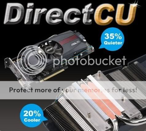

June 11, 2010 9:07:57 PM
darkslash_323 said:
Really?....which one has the voltage unlocked?...cuz I only know the MSI Afterburner can do that....but I really don't want hot air being blown back into the case with the Twin Frozer HSF.
It doesnt matter if the hot air is released inside your case unless you have terrible airflow. I have an Asus 5850 DirectCu (non-reference) that barely raised my case temps. It runs cooler than most 5850's even if pushed past 5870 speeds. Just to give you an example I can overvolt the DirectCu from 1.18v to 1.2v and still achieve a 32c IDLE @ 70F ambient. I can also overclock the card to 1050/1300 1.26v and it wont reach 70c unless my ambient is around 80F. The best part is that you can get one for 320.00 "free shipping" over at zipzoomfly.com.
http://www.zipzoomfly.com/jsp/ProductDetail.jsp?Product...
Here is a pic of the DirectCu :
The MSI 5850"Twin Frozr" is a terrible buy, not sure how MSI dropped the ball on that specific 5850 because the 5770 and 5830's (Twin Frozr's) are considered great buys in terms of quality.
