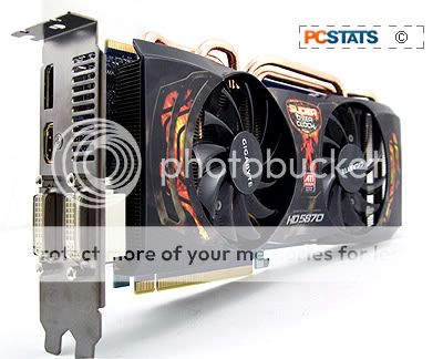

Well an aftermarket overclocked 5870 is not going to cost 100$ more than a 5850. Lets take this GB card as an example :
http://www.newegg.com/Product/Product.aspx?Item=N82E16814125323&cm_re=5870-_-14-125-323-_-Product
as you can see the above 5870 is priced at 499.99 and the clocks start at 950/1200. The DirectCu can do 1000/1275 easily just by raising the clocks/volts. I think this is what AMW is trying to explain here.
