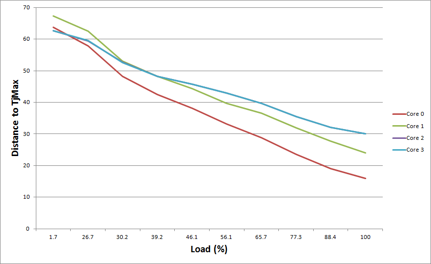

Note that the graph shows the delta to the maximum temperature for each core vs load, not the temperature vs load. Thus higher is better.
http://i176.photobucket.com/albums/w179/random1301/temp-vs-load.png
It's pretty easy to see what's going on here. Cores 2 and 3 track together perfectly, such that one line hides the other. You can see that Cores 0 and 1 follow a similar shape to each other but with an increasing distance between them as load increases. This is rather odd because normally you'd expect that the readings would converge as load and temperature increases (sensors are more generally accurate at higher temperatures), but here the opposite is true.
Your earlier post makes it sound like you swapped out the heatsink, but did you mean that you changed it at an earlier time or after your discovered this problem and you were suggested to reseat it? If you haven't done so, reseat it and see if your results are similar. If they are, it's possible that the heatspreader on the CPU and/or the heatsink base is not flat enough. It could also just be dodgy sensors. 45nm Core 2 CPUs are well known to have dodgy sensors, but typically the problem is at idle, not load. That doesn't rule out the plausibility of it occuring in some cases though.
