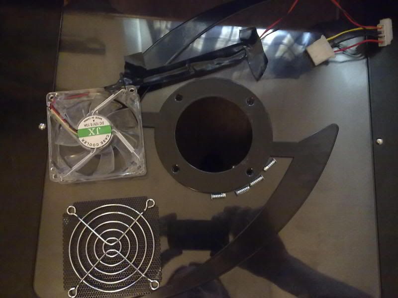

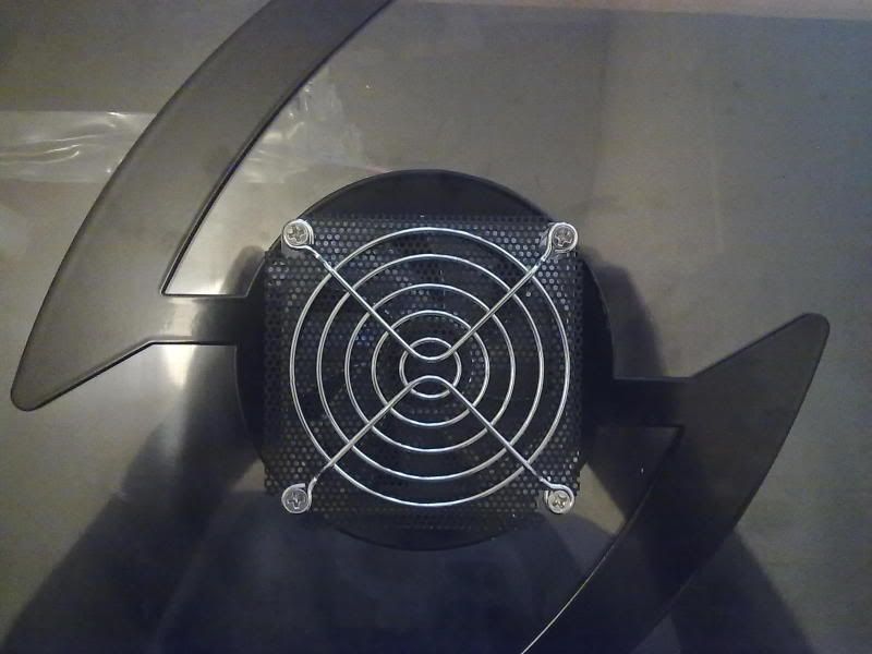

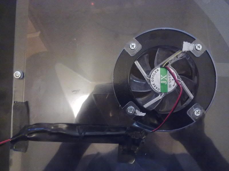

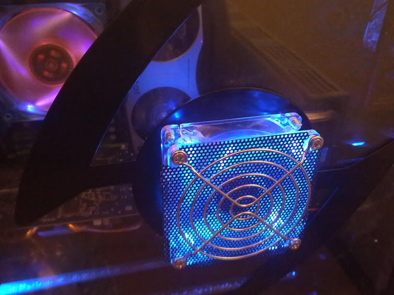

Ok, done,
Masterclass on how to install a fan outside the case,(retaining intake airflow)
Fan in original placement on window, inside,intake
remove fan,including any mesh and grills you may have
Feed wire through hole from outside to to inside of case, note 'rear' of fan is facing the hole
Screw fan to window (From inside the window) using original screws, careful not to crack acrylic :)
attach any mesh/grills on face of fan outside of window, new screws required
Enjoy intake fan on outside of window and clearance inside for your Megahalems :)
