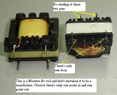

As you were told with the last one, chokes do not mean passive PFC. They will be present in the filters (all of them, including input) of any PSU.

PreferLinuxAs you were told with the last one, chokes do not mean passive PFC. They will be present in the filters (all of them, including input) of any PSU.
Just looked into this: the problem was the translation from German. I just edited to make that passage more specific.

"A PSU equipped with a big choke like in the photo above is a clear indicator of passive Power Factor Correction (PFC). Passive PFC plays a significant role in the efficiency of the PSU. Only active circuitry allows for factors close to the optimum value of 1, while passive components can reach 0.7 to 0.8 at best, meaning they only achieve 70% to 80% efficiency. PSUs with a passive PFC may be cheaper to buy in the short run, but poor efficiency can swallow savings over time in the form of higher electricity costs."
This is absolutely wrong. PFC has nothing to do with efficiency; it has to do with the type of load the PSU presents to the power grid.
"The responsibility always lies with the buyer to recognize and reject products that are obviously unsuitable."
Only if the product's label is accurate. If it isn't, it's consumer fraud; simple as that.

jtt283"A PSU equipped with a big choke like in the photo above is a clear indicator of passive Power Factor Correction (PFC). Passive PFC plays a significant role in the efficiency of the PSU. Only active circuitry allows for factors close to the optimum value of 1, while passive components can reach 0.7 to 0.8 at best, meaning they only achieve 70% to 80% efficiency. PSUs with a passive PFC may be cheaper to buy in the short run, but poor efficiency can swallow savings over time in the form of higher electricity costs."This is absolutely wrong. PFC has nothing to do with efficiency; it has to do with the type of load the PSU presents to the power grid."The responsibility always lies with the buyer to recognize and reject products that are obviously unsuitable."Only if the product's label is accurate. If it isn't, it's consumer fraud; simple as that.
I disagree, the PFC is signal of passive or active components and while the 1st ones are more cheaps, the 2nd ones are much better.
Agree on the 2nd part.

Saint, I was quoting from the article about PFC. Power Factor Correction causes the current and the voltage to match phase, same as a simple resistive load. It has nothing to do with efficiency.

Correction: OVP does not refer to the presence of a MOV. Overvoltage protection (along with undervoltage protection) is a secondary side protection and is implemented in the secondary controller.
SCP and OPP are primary side protections. SCP is, in cheap units, implemented via a fuse. In at least semi-quality units, it and OPP are implemented via the PWM/PFC controller. For instance, the common CM6800 controller family have integrated SCP and configurable OPP.
OVP, UVP, OCP, and OTP are secondary side protections, implemented in the secondary controller. OVP and UVP are almost always present in even the cheapest units; however the sensing circuitry used in the cheap controllers those units use can only guarantee protection values of, for instance 14.6V on the +12V rail, way out of spec. So the protection is there, but isn't particularly useful. The implementations used in quality units are far better because they use better secondary controllers. OCP is either integrated into the secondary controller or is added via an extra IC. It also involves one large shunt resistor per rail monitored. Finally, OTP is usually just a thermistor on the secondary heatsink that sends a shut down signal to the secondary controller when the PSU gets too hot.
A MOV is an anti-surge component installed in the EMI filter (before the primary) that absorbs a portion of an incoming surge and dissipates it as heat. The higher rated the MOV the more useful it is for surge protection. Some budget units use very low-rated MOVs, such that no real surge protection is given. There is actually a shortage of MOVs in China; there are more PSUs being made than MOVs. So the price has risen dramatically, and even quality PSU makers are finding ways to rationalizing removing the MOV, such as saying "Well everyone already uses surge protectors anyway".

Also, chokes/coils are not an indicator of passive PFC. Nearly all power supplies use chokes for several roles, including EMI filtering, active PFC (when paired with a cap and two mosfets), voltage regulation, ripple filtering, LLC resonance, and several others.
The inductors used for passive PFC will resemble a transformer more than anything else, usually having a form factor like this:
They'll often be nearly as large as the primary transformer, occasionally larger.
You've been improving this article, but it's still a long way from being a definitive reference.
Sigh, this was another bad translation spot. I've since corrected it in the story. Thanks for pointing it out; should have been spotted before going live.
