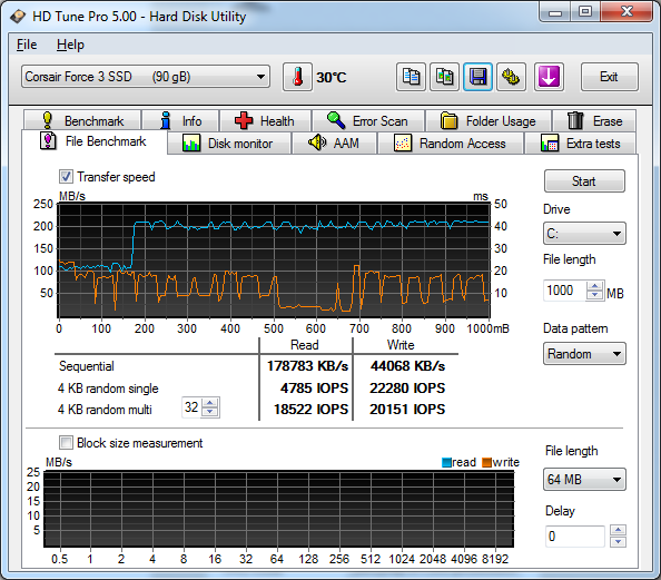

Alright I ran the transfer test on HD TUNE. Also, the alignment looks alright on all the drives, cept it couldn't read my E drive for whatever reason. The smart values also came out alright. AS SSD and Crystaldiskmark both show around the same values, with AS SSD being slightly less on speed. Should the write/transfer speed be even across the test like the read? Also I ran a quick error check, and it came back alright as well. (Im running a full error check now just in case)

a c 104 G Storage
October 27, 2012 10:33:40 PM
Run the HD Tune Pro again but run the READ Benchmark Test across the whole drive drive. You can copy the screenshot using the button on the toolbar giving you the whole image. You can't run the Write test without wiping out your data, so don't do that.
