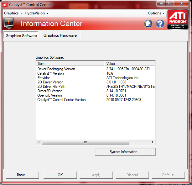

I uninstalled all the drivers using the function given me by the ATI catalyst control center. I then ran the driver sweep in safe mode and eliminated all the drivers under the ATI category. I then rebooted and installed the latest and greatest for my card. Here's the link in case I messed up: http://game.amd.com/us-en/drivers_catalyst.aspx?p=win7/windows-7-64bit. I then rebooted and started up World of Warcraft and it turned into a series of bars that matched the color of the UI. The same happened for Crysis.
Any other suggestions?
