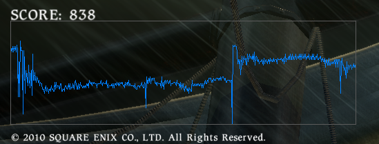

Regardless, I just haven't been feeling like the SLI is doing anything. I've been getting some decent gains in places, but I feel like I've been getting a crapload of visual tearing and microstutter as well. It was brought to my attention when I tried out the FFXIV benchmark and found my FPS line jittering a lot:
The sudden jumps are mostly changes in the scene, but the constant up-and-down motions aren't.

In general you do get some up and down with FPS like that, although the larger ones at the beggining are interesting as are the 3 large dips.
Screen tearing is generally due to too much FPS. Enabling VSync should fix that.

Erhm, according to another thread the FFXIV benchmark doesnt' correctly use SLI (becuase it is windowed mode), and that is why you are getting poor marks. This is the reason you are doing so bad in the FFXIV bench, and thus it isn't something you should concern yourself with.

Yeah, I would much use Furmark or 3DMark instead, or game-based one's like Crysis and STALKER: CoP.

I'll try that tomorrow and see what happens, then, but thanks for pointing that out.
