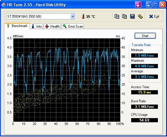

I'm running a 500GB Seagate Barracuda 7200.12 SATA HDD (for OS and various software) that keeps switching back to PIO mode. I've tried the following methods (in no particular order) but it still reverts back to PIO mode after a few boot-ups.

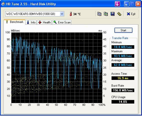

1. Replace SATA cable with the one that I'm using for my 1TB (1TB works flawlessly)

Below are a few screenshots of HD Tune diagnostics:
Benchmark of 500GB running in PIO mode
1TB running in Ultra DMA 5

Is this a symptom that my HDD is failing soon? Or is it a motherboard issue? Any solutions that might help solve it?

This is a known bug with XP, where drives just randomly seem to get set to PIO mode. However, the HD Tune image at the bottom is a bit troubling, so I'd be sure to hit the manufacturer's site and get their diagnostic program. You may well have caught the drive in the very early stages of failure. If you don't have a backup of anything important on that drive, now would be as good a time as any to make sure you do. Even if it turns out it's just the XP DMA bug and nothing else, you generally can't go wrong having a backup of important data.

You also have a current pending sector count of 9. I'm surprised this isn't flagged also. It looks as if the drive is on it's way out. You may want to make a backup soon, just in case.

Windows XP will switch from DMA mode to PIO mode if it encounters 6 CRC errors.
There are some solutions and workarounds here:
http://winhlp.com/node/10
The following article explains how to edit your registry so that 6 consecutive CRC errors rather than 6 cumulative CRC errors are required to trigger a switch to PIO mode:
IDE ATA and ATAPI disks use PIO mode after multiple time-out or CRC errors occur:
http://support.microsoft.com/kb/817472
It involves adding a "ResetErrorCountersOnSuccess" entry.
Your SMART attributes are explained in the following article:
http://en.wikipedia.org/wiki/S.M.A.R.T.
HD Tune is not the best SMART tool, so I would ignore its warnings and interpret them for myself. For example attributes 0A and B8 are perfectly OK (normalised value = 100, raw value = 0). I believe HD Tune's warning is triggered because the Current and Threshold values are "too close".
Attribute B7 is telling us that there have been 124 SATA Downshift Error Counts, so this would suggest an interface problem. However, the UDMA CRC Error Count is zero, so this seems inconsistent (?).
Attribute BB is indicating 415 Reported Uncorrectable Errors, and there are 8 Reallocated Sectors and 9 Pending Sectors (as already mentioned), so I expect that these may be causing the PIO problem.
Attribute BC appears to be reporting 10 (= 0x000A) Command Timeouts.

SeaTools for Windows sometimes has problems with certain SATA controllers or drivers. Instead you could try running SeaTools for DOS from a bootable CD.
In any case, it's definitely a drive problem.
