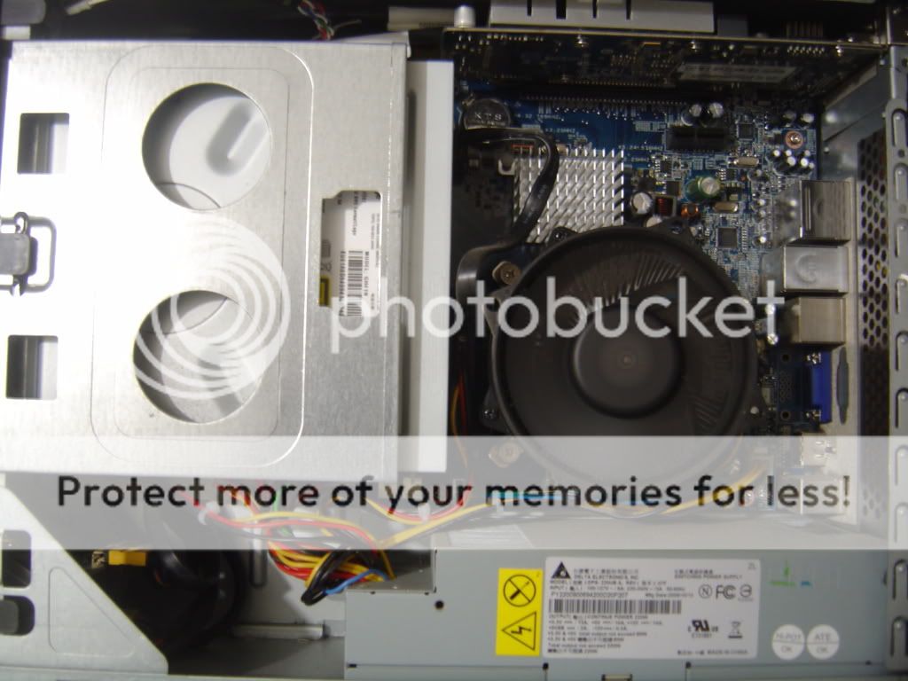

I have an Acer Aspire X1301-u9052. I want to upgrade my 521mb graphic card into an Asus EAH5670/DI/1GD5 Radeon HD 5670. But the problem is the new graphic card require PSU at minium is 440 Watt , and mine is just 220 Watt. Anyone know how can i upgrade my PSU. My case is small so there are not much PSU that i can choise. Can anyone give me a product to try???

It looks similar to mine but im not sure that they are the same. i uploaded a video on youtube so you can have a look at my pc. you can see the PSU at 0.15
http://www.youtube.com/watch?v=S8htpnVqXDE
_Aries_ said:
It looks similar to mine but im not sure that they are the same. i uploaded a video on youtube so you can have a look at my pc. you can see the PSU at 0.15http://www.youtube.com/watch?v=S8htpnVqXDE
That PSU is really blurry I cant really tell if it is an OEM design made to fit in that case only, or if it is flex ATX PSU
Is it like this?

Hello _Aries_, Welcome to THW.
Is there any chance you can just give us the Brand and Model number off from the PSU, that should be able to give us the information we need to help you out.
As for the power requirements of the EAH5670/DI/1GD5 it should be 400w as stated here: http://www.tigerdirect.com/applications/SearchTools/ite...
the 5670 does not require 400w, its just reccommended to use a 400w PSU. They give this reccommendation to account for poor quality psu's that label their products incorrectly or as a peak power rating. http://www.techspot.com/review/240-ati-radeon-hd-5670/p... you can see that its max is just under 250 watts at the wall for the full system. a power supply that can deliver 300w continuous power should be fine.
I posted another video so you can take a look at my PSU.
http://www.youtube.com/watch?v=79j4I21jaH0
following is some information on the PSU which is in English ( some is Chinese) that i could read.
Model : DPS-220DUB A, REV:07F
INPUT: 100-127V~/6A
220-240V~/3A
50-60Hz
OUTPUT: CONTINUE POWER 220W

Hey _Aries_ , after doing alot of searching I really couldnt come up with a PSU to match the one you have in your PC currently without knowing the name of the form factor, its is quite difficult.
I have come across this: Diablotek PHD Series PHD380M 380W Micro ATX Power Supply, which may fit with its measurements of 4.8" x 3.8" x 2.5" vs 6.89" x 3.39" x 2.56" of the PSU you have now. This PSU will give you 160w more to power a nice video card for you.
Now the only questions are will the screw holes on this PSU match where they are on your case, which I cannot answer without knowing what the form factor is. And how much room do you have around you PCI-E slot to fit in a new GPU card?
If you can try to measure for how much room you have to fit a new PSU in your case and check and see if the PSU I mentioned above will fit. Also measure how much extra space you have around you PCI-E slot and post the measurments. One other thing, if you have another standard style PSU availible to you, check and see if the mounting holes for the screws match, this will be very helpfull to know

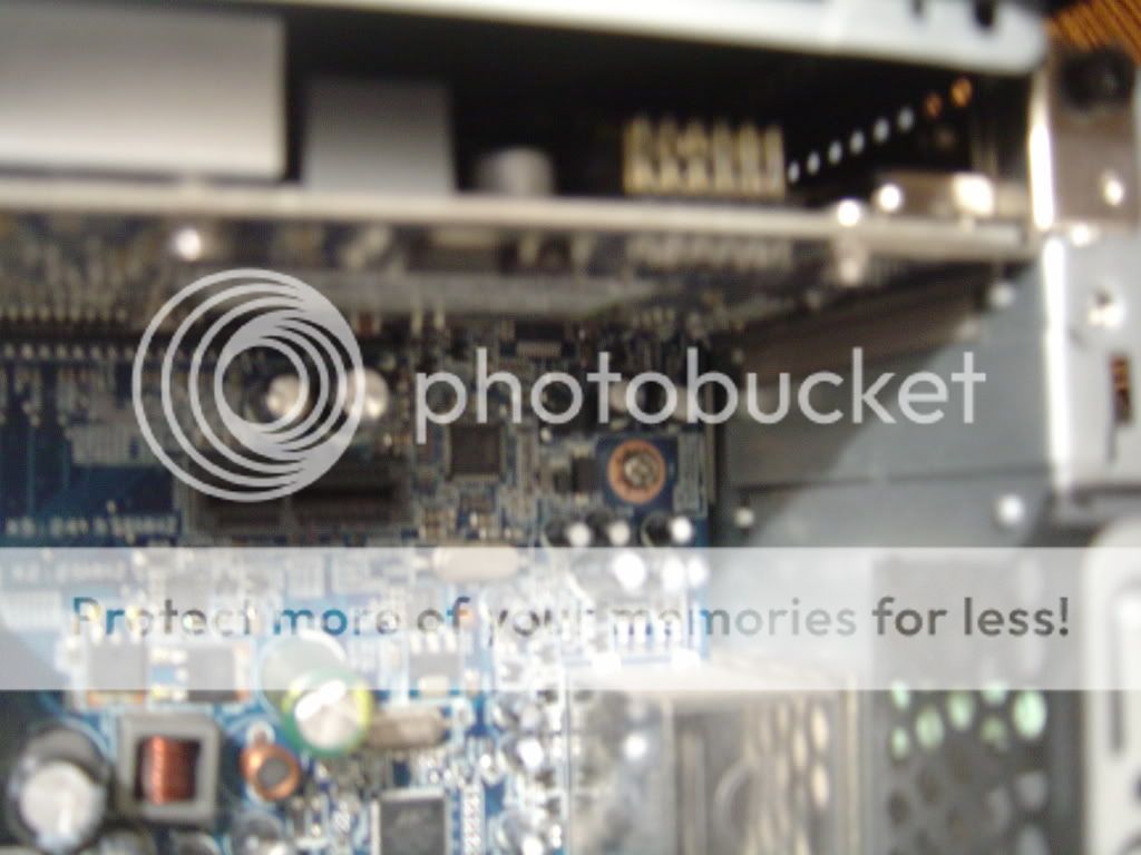

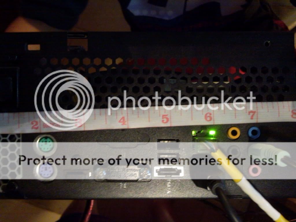

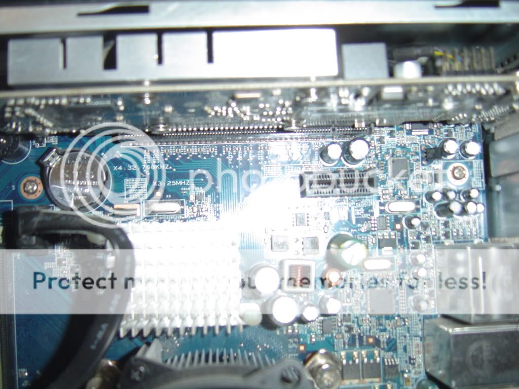

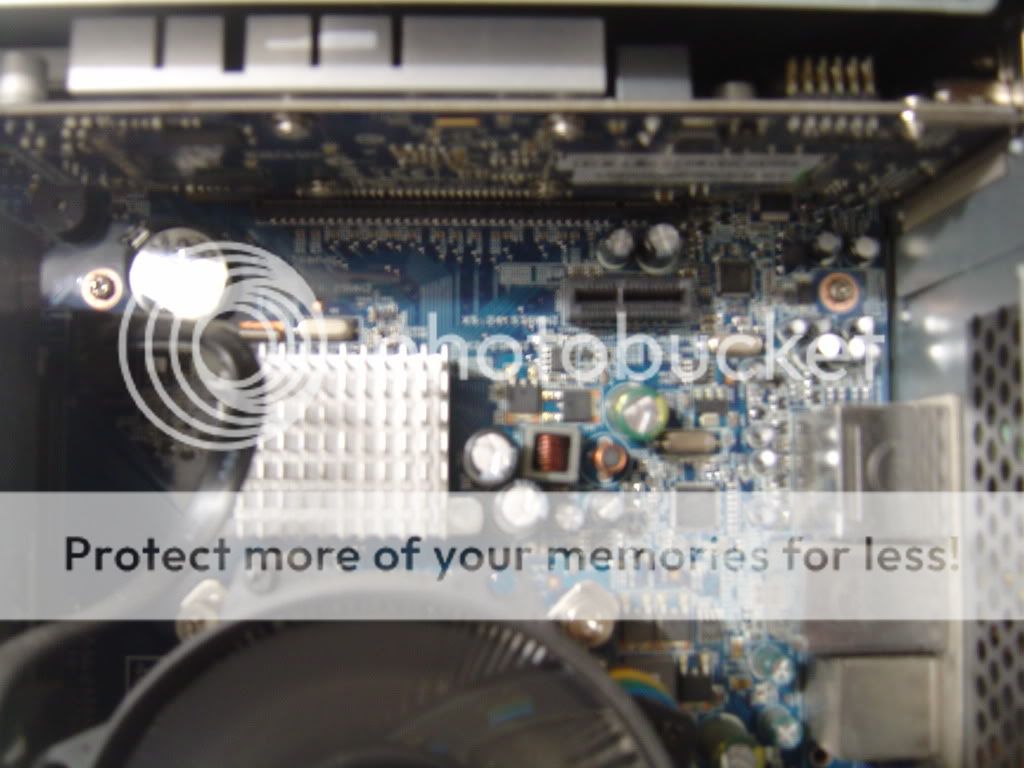

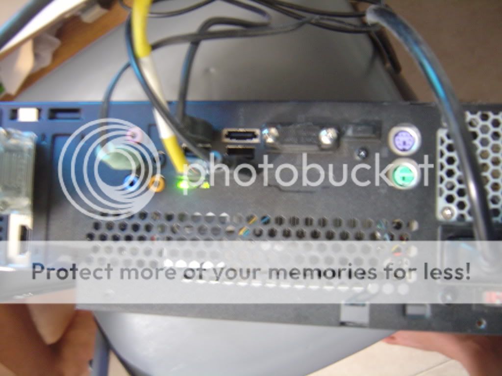

Thank alot for your help. I checked my PSU. This is form factor, it's not the exactly number but it's very close.
it's about 3.8in x 2.1in x 8.8in (this long side , i still have about 2.3in free space so it can be up to 10in).
This GPU has the same shape with mine. ASUS EAH5670/DI/1GD5 Radeon HD 5670 1G . http://www.newegg.com/Product/Product.aspx?Item=N82E168...
If i used this one the GPU'sfan will face with my case'top roof.
my case have about 1in free space for the side that face the top roof and about 2in free space for other side.

It's ok if the GPU is a little bit higher my old GPU because i can take out the side case's shield( i dont what it's called).

Here is a low profile 5670 that willl fit. its HSF is kind big though.
That would be a UPS (uninteruptable power supply) which has batteries which would allow the system to run for a few minutes upon a power loss.
Your PSU sounds like a flex ATX PSU, maybe TFX, I am not really sure.

Ok, I am still unsure of what PSU will be able to work in your case without doing more research with the dimensions you listed, but I can give you my thoughts on the GPU. From watching your video you have posted it seem that you have very little space between the top of the case and your GPU, it is kind of hard to tell how much clearance you have. But with the ASUS EAH5670/DI/1GD5 Radeon HD 5670 it seems to me the fan will be too tall:
ASUS
So I am going to stick to my suggestion of the: XFX HD-567X-ZNF3 Radeon HD 5670 1GB 128-bit DDR5 It has the same specs as the Asus, it is $10 cheaper right now, it is slimmer than the ASUS, and you get a lifetime warranty rather than 3-year.

Problem is he has a low profile case, those cards will stick out 1-2 inches, he wont be able to screw it in so they will only be held in my the motherboard PCI-Express connector. So if he trys to plug in a cable into the graphics card slot he could accidently disconnect or loosen the the pins from the motherboard causing a short which could damage either the VGA, motherboard, or PSU.
Edit: I see you have sorted out the problem yourself, best of luck.
The best thing would be to take out everything and put it into a new case and the PSU/GPU problem is solved, you can get anything and cheaper. In order to do that we need to know what form factor is your motherboard.

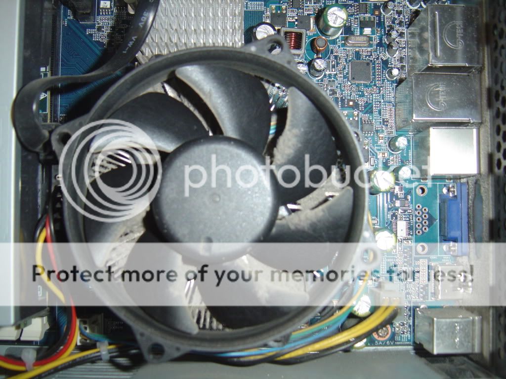

Anyway, ATX is 12 × 9.6 in (305 × 244 mm)
mATX (that's probably what you have) is 9.6 × 9.6 in.
Is this your mobo?
http://www.ecs.com.tw/ECSWebSite/Product/Product_Detail...
Thew next best is to get a PSU that fits in your case or put it outside and a single slot low profile video card but I suggest changing the case.

Alright _Aries_ ,
I think I have this all figured out for you now. Far as I know the PSU in you PC is called a TFX form factor or Mini ITX IDK, as I suspected but I didnt want to throw out any guesses, and snipergod87 also suggested it could be TFX.
So I put your PC specs into Antec Power Supply Calculator and came up with 263w to power you PC, thats with the new GPU. I gave you the link to the calculator so you can check this yourself also.
When it comes to the TFX or Mini ITX form factor PSU's they seem to not exceed a 300w limit, so I have found this one: SeaSonic SS-300TFX Bronze 300W on Newegg.com that should fit your needs as long as its the right for factor and not Mini ITX instead, but IDK, and you dont add anymore componets to your PC, that is after your video card of course. Seasonic is the TOP manufacture of PSU's so you do not have to worry about quality, it also is a 80+ bronze rated PSU so you will have good power efficiency.
As for your video card, just to say it again, I recommend you get this, unless as mosox says its low-profile then forget about this card: XFX HD-567X-ZNF3 Radeon HD 5670 1GB You have unitl Nov. 30th to still qualify for the MIR.
Well I guess that does it, I hope that answers the questions you had. If you have any other concerns about what I have covered just let me know.

Measure the mobo
Post a pic with your case expansion slots (the part with the connectors).
http://support.gateway.com/s/CASES/3501763/3501763rvr23...
i just found out how to post picture into my post. I take some pictures and post on here, hopre it will help you guys to find out about my motherboard. ( i can't measure the exactly about my mobo because the cd-room is blocking my view. i measured it and they are about 10in x 8in.And about the expansion slots : there is just one slot for the VGA, and another slot for some thing that small. This SeaSonic SS-300TFX Bronze 300W will not fit my case, because it's measure is 6.9" x 3.3" x 2.8" ( mine is 8.8"x3.8"x2.1")
Here is some picture:
In right top is my VGA and on it's right side is two expansion slot ( one for VGA and one for that small black thing)
This is my PSU, if you could zoom in then you can read the information on it.
This is my damn Cd-room which the RAm is under it and this Cd-room also block me from taking the ram out.
I'm searching the exactly model of my mobo now so ill post it when i found out.
Edit: I think im sure my mobo form factor is Mini ITX ( not exactly the same with the mobo i see on this websites http://www.ecs.com.tw/ECSWebSite/Product/Product_Model....) but they have same side.

I just found out how to take out the damn Cd-Room, and it gave me a clearly look on my mobo. There are two more lable on my mobo, and they are:
MBSCM01002930077030A1
GUD:001D72FFB4CBECFF
AGAIN: my mobo factor is 9.6 x 8 in. I had measure it 6 times.
This is a picture for my mobo. The processor socket is under the black fan.
This is my PSU . It's measure is 7.9 x 2.1 x 3.1 in . This measure is include the missing part which will help my PSU fully b a rectangle. the measure for that missing part is 0.6 x 1.2 x 3.1 in.

This is a picture i took with the ruler on it.I need to turn off the light so you can have good look on the ruler.The ruler is in inch and don't mention/just ignor the small number 60inch. Top of my case is from the right. Next to the number 7 is the VGA's slot.

Nope, I meant the 6 screws that secure your mobo to the case. I think that mobo is a spinoff from mATX (it's shorter) but they kept some of the standard mounting holes.
http://i.imgur.com/MXMU8.jpg
In this pic you can see the 6 screws, 3 on each side. The first one is on top left side, beneath it it's the second one next to the battery and RAM and the last one on the bottom left side.
You should have 6.1" between the first and the second, 2.85" from 2 to 3.
On the right side the first one is 0.9" lower than the first one on the left side, the rest are aligned with the ones on the left.
The distance between the two rows from the left and from the right is 6.45".
If that measurements are the same it means the mobo fits a regular case. Do you have any friend who has a case laying around to test?
