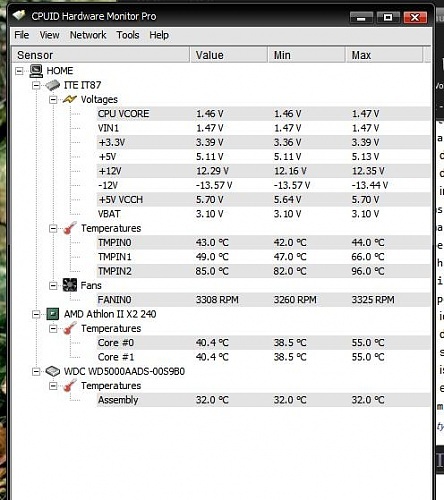

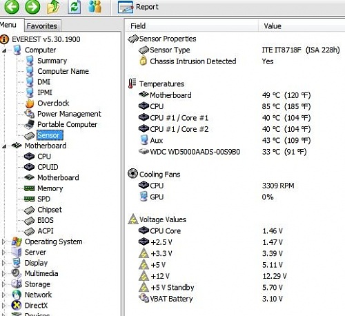

I used everest to get to the root of this. It gave me three distinct temperatures - CPU Temp, CPU #1 Temp, and CPU #2 temp. While the individual temperatures of the cores are normal, the first temperature listed is abnormally high - 90 - 100.

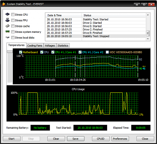

I also stressed my CPU, and the beeping sound returned, most notably when stressing the cache.
Does anyone of your know what this means?
BTW: The beeping starts immediately when stressing the cache, in 1-2 secs or so, before temp build.

The problem is, the processor itself is not hot, as you can see from the images.
I stays at a normal temperature. So no thermal paste here.
Also, i've read around the internet that TMPIN2 readings are wrong.

And my biggest question is: If the processor stays at a normal temperature, why does the beeping start immediately when stressing the cache in Everest?

Yes, but i must repeat myself - since the readings are normal for the processor, but abnormal for the motherboard, which one of them is running hot, considering the CPU cache stress test?
What i am trying to find out is the reason for this abnormality - the CPU readings being OK, whilst the beeping immediately putting up when stressing the cache.

Everest is reporting CPU temperature of 85 C. 85 C is not normal.

Yes, everest does report 85*C, but CPUID reports that temperature (85) under the TMPIN2 sensor.
I am sorry, but almost no one has so far thoroughly answered to my specific question !
There is a discrepancy between what CPUID reports, what Everest reports, etc, as i have previously stated.
November 21, 2010 12:33:47 PM
Update: I think i figured it out.
Everest's CPU temperature is bogus. The REAL CPU temp is CPUID's TMPIN1.
I deducted this by observing that the beep turns on when TMPIN1 surpasses 60*C, the alarm limit within the Bios.
