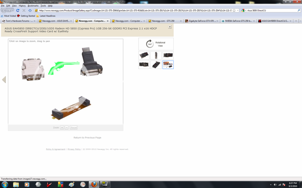

well, I am getting a 140mm for the front of my case, and I'm putting an industrial blower in the side of it as well... so I guess Airflow wise I'll be okay :)  thanks for all the help, and I plan to get this until the 6xxx series comes out... right now, my 5770 is enough to play BFBC2 maxed, at about 40fps, and all my other games exceptionally well... Crysis just pisses me off though, so this oughta run that at 1024x768 right? and plus, I'd like to hold on to this until the 6xxx series drops a lot in price... Finally, and most importantly, those heatpipes always look sexy on any computer part... so I'm getting the Asus DirectCU one... if you're sure it comes with an hdmi to dvi then I'm getting it as soon as I sell off my 5770. Thanks mate :)

Hey man, I got the EAH5850 and it's looking good :)  thanks for all the help, and this sucker is FAST! thanks again :D
