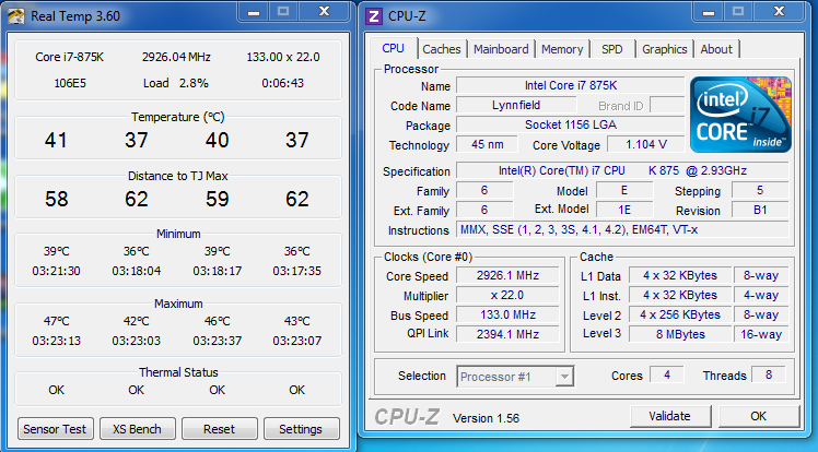

Using my Corsair h50. Now I had the same cooler on my Intel Core Q9300 and it ran hot on that aswell, I just assumed that the Q9300 just ran hot. Is this a normal temp with Liquid Cooling?
Thanks.

Awesome, It was running really hot at like 83c with prime95. I realized my motherboard had my Vcore set to 1.35, so I set it to 1.15. and temps have settled.
I'll go get Artic today, Also with these current temps for 35-40c idle, there really isnt much room for an O/C is there?
Also now I realize, Yes I am using Push, pull.. but I might switch the stock fans with my 130cfm fans, if it would help at all.

Alright, After some runnings with Prime95.
My averages are from 34C on idle to 67c on 100% load. As soon as my cpu goes back down, instantly my temps get pushed back down to 40c. Whats the limit on temperature with these I7s? 70c?.. If so, it seems like I don't have much room for o/c. Realistically I would love to reach 3.6ghz or 3.8 at most.

Weird, my default Easytune6 software that came with my Gigabyte board. Says the CPU is running at 30C when Coretemp says 40C. How do I know which one is right? ^_^

December 6, 2010 8:45:29 AM
Speedfan gives me a BSOD for some reason =p
Got CPUID Hardware monitor, and of course its the higher one. So its not 30C it's 40C, but I'm not sure.. because Easytune is the software that came with my motherboard... If that matters at all lol. :(

Just got some TIM, I JUST put it on and i'm getting temps idle-33c and load of 51c
and that's overclocked at 3.2ghz :)
Question: Now I did put a little pea size amount on and circled the heatsink on it so it could spread. is a peasize amount enough?

December 11, 2010 4:20:57 PM
Alright, just put it on as directed. :D
The results are enjoyable, maybe I'll even get lower after it cures!
--- Edit ---
Okay, so for the sake of it I tried to take it to 4ghz. I ramped the Vcore from 1.2 to 1.23 and changed the Multiplier to 30 (not sure if changing the freq would be better), Surprised it actually booted. here is what it idles at!
