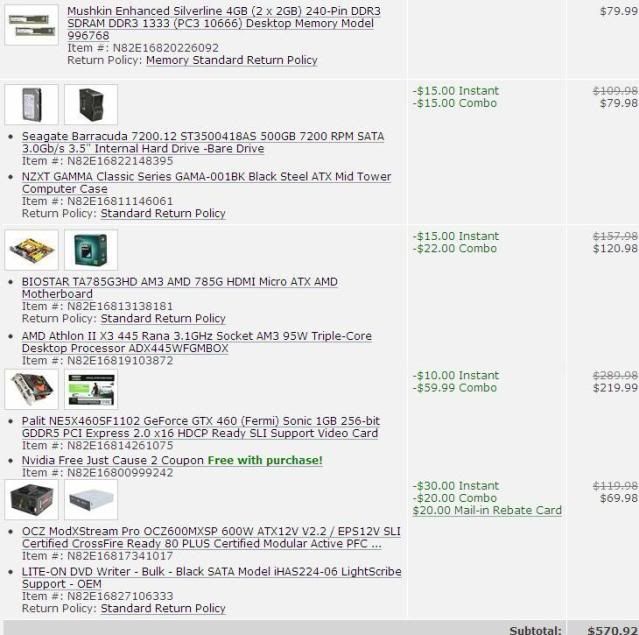

If you're in the US, then you can order these from Newegg.com. Just ordering the listed combo deals will get you the discounts, but you may not get the best possible parts in the bargain.
Go with the CPU Batuchka linked - Athlon II X3 445
Please change the Biostar Motherboard to Asus/Gigabyte/Asrock/MSI - ASRock 770 EXTREME3 - With USB 3.0, SATA 6GB/s, eSATA 6GB/s.
& that deformed NZXT case to the one I use - COOLER MASTER Elite 310
Much faster RAM - Mushkin Enhanced Silverline 4GB (2 x 2GB)
The rest of the parts look alright. The following changes are optional -
HDD : SAMSUNG Spinpoint F3
ODD : LG SATA DVD Burner - Bulk LightScribe Support

what about the rosewill challenger its 5 bucks more but has 3 more installed fans and also what else to i need to build a desktop i have never done it before and i dont know what else i need

The Rosewill challenger's a very good case for it's price. Get it if you want to. That combo looks fantastic with $25 off.
You asked 'bout Palit as a brand. They do pretty well for themselves. Personally I prefer EVGA for NVidia & Sapphire for ATI. Asus/Giga/XFX/MSI & also PowerColor/Zotac etc are not half bad.
I wouldn't worry too much 'bout a Palit, but if you're not too sure, you might as well get a - $230 EVGA GTX 460 (Fermi) 1GB - This superclocked version costs only $10 more than the stock version. So no reason not to go for it, especially since it doesn't sound like you're gonna be OC'ing your GPU any time soon :)

There are only 2 Rosewill TU-155's. The one with a PSU costs 70 & the one without it costs $50 + $10 shipping. Rosewill Cases (& PSU's, I might add) are pretty alright, so you might as well go with it if it catches your fancy.
The Gigabyte GPU does have some adverse feedback, but then every product will always have that. No matter which brand. It's also technically a shade faster. So might as well go with it especially if you can get some savings.
Do make sure, that you get an extra 4 Pin Molex to 6 Pin PCIe connector. Costs just a few bucks.
OCZ does have a few adverse reviews on it's RAM's of late. I dunno if it's just a bad bunch or if there's something more to it. Personally I think it's just people leaving the settings on auto when they should be manually inputting 'em. But still, I think going with Corsair/G.Skill/Kingston/Mushkin for now till the issues get sorted out is prolly the way to go.
