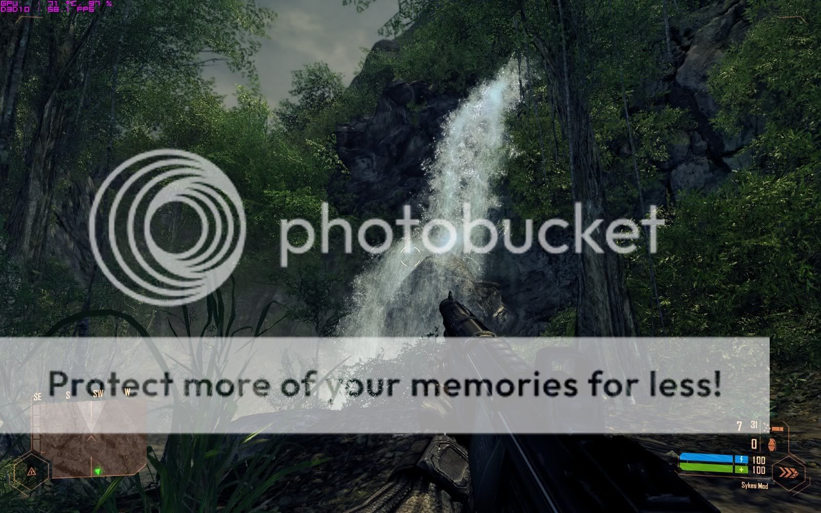

Stock CPU and GPU :
The FPS is located on the top left hand corner
CPU @ 4Ghz / GPU at 950/1250 :
Just like a few already stated, the lower the res the more stress on the CPU so at lower resolutions you will gain FPS if you raise your CPU clock, at higher resolutions you will gain FPS by raising the GPU clock. Your should also be able to get at least 800Mhz out of that ram, also play with your timings. I have an old set of Patriot 667Mhz ram that does 870Mhz on stock voltage.
775/1000 is the stock clock for your GPU (157/300 is your 2D idle clock), Use Smart Doctor to raise your clocks/voltage and you will definitely see a gain in frames.
