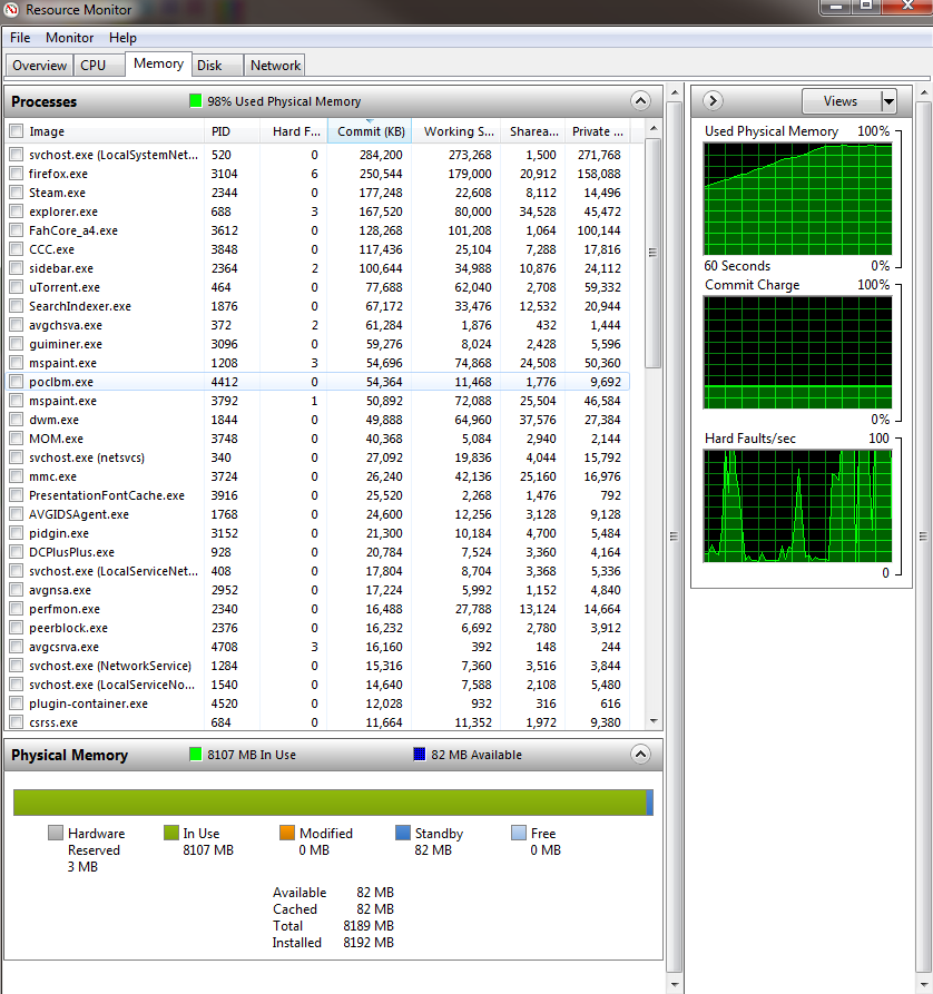

Hello everyone.
My system has recently hit a very strange wall with memory.
Every once in a while, my system will spike its physical memory usage up to 100%. For usually no aparent reason.
I've tried looking in task manager, and resource monitor to see WHAT is using all of my memory, but when I do, their is never any program using an unreasonable amount of memory!
Here is an example image from the Resource Monitor:
What program can I use to find out more about EXACTLY how much memory is allocated by each process? The system is CLEARLY using more memory than the sum of the pieces from each process. So how do I figure out what is using it?
I've heard performance monitor is a great tool, but I have no idea how to use it. And I'm not even sure if that program will be able to tell me anything useful...

Well, my issue is more the fact that my computer says I'm using all my memory, but fails to tell me WHAT is using all my memory.
If you add up all of the Committed pieces of memory, you'd get only about 2~3 GB. Well below the 8GB it says it is using.
I'm not too worried about a couple processes using half a gig of ram. I'm worried about one process secretly using up 6GB of ram!

BUT I believe I've found at least 1 culprit!
explorer.exe.
Sometimes, when I'm in a folder with a massive video file, or I try to move a massive video file, my RAM spikes to max.
Killing explorer.exe brings my RAM back to normal.
It does still worry me that I could never see any sort of a spike in explorer.exe's memory use... ah well!
