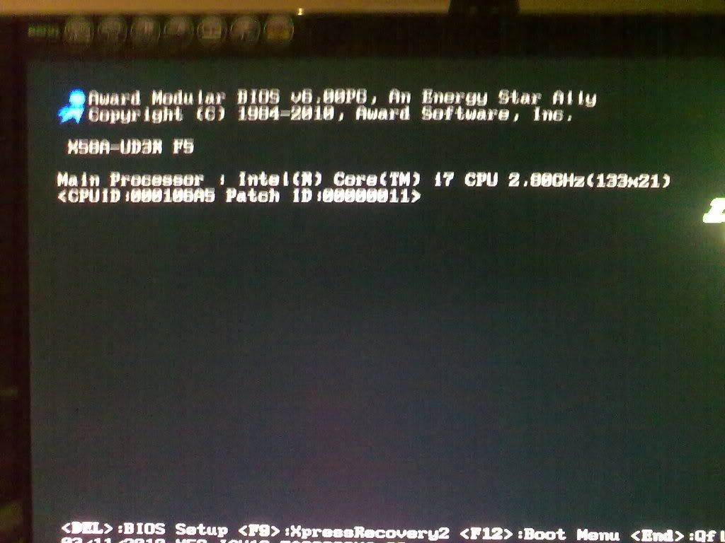

When I boot the computer, it appears to freeze (or pause) during the startup and then continue as usual about 5 minutes later.
Once I press the power button, this screen appears within 5 seconds (as it always has).
However, it then pauses for a number of minutes before the rest of the screen loads.

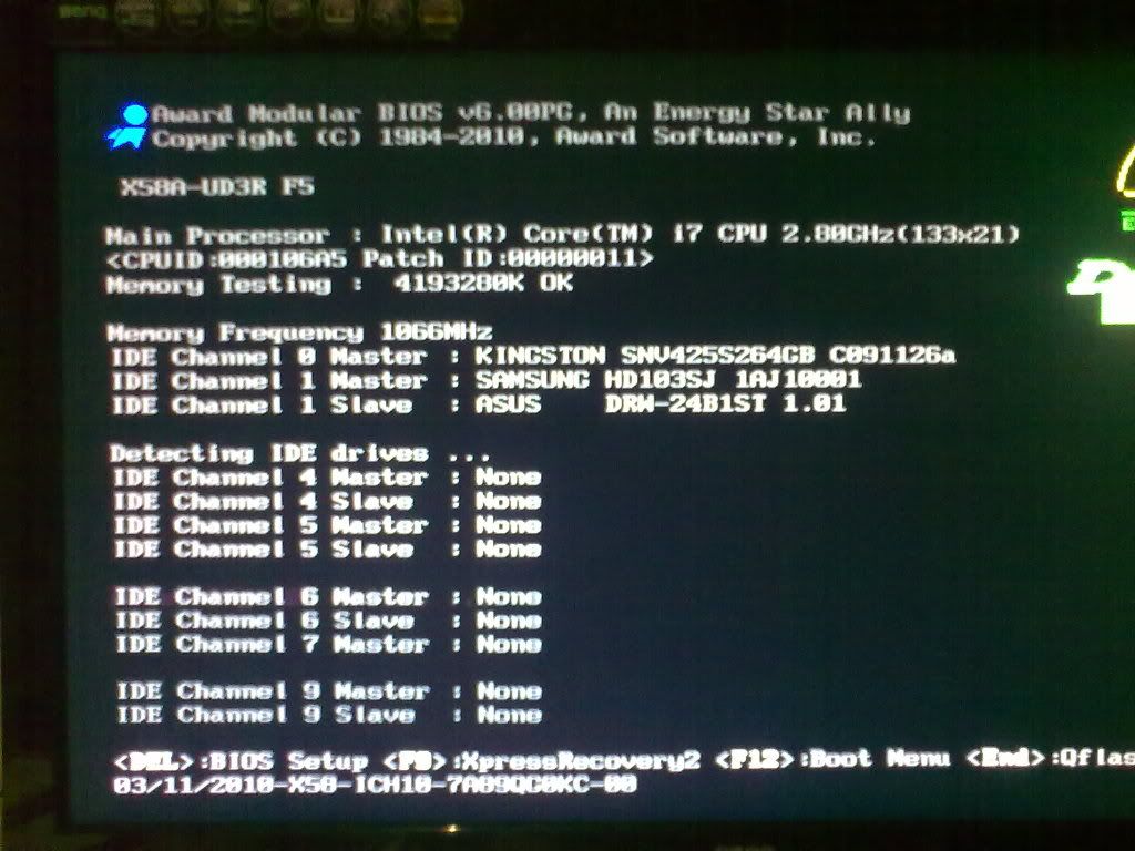

Showing this:
What normally (used to) happen is that the first of those screenshots only appears for a few seconds and then the rest of the screen loads.

As has previously been stated it appears that the computer is getting stuck on the memory test. Have you checked the BIOS to see if quick boot (or equivalent) has been enabled? Another cause for the computer to become stuck at this point is a failing hard drive; the computer could be waiting for a hard drive to become ready.

Is that it found 6gb of memory rather than 4 (as in picture) last time it restarted.
Could this mean anything?
