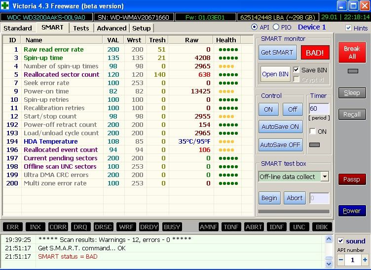

I installed Victoria HDD for Windows to check my WDC HDD's condition and possibly fix it. I've been doing read-remap, read-erase commands so far, they helped to reduce a number of sectors with reading higher latency, but smart status is still bad. I guess there should be some bad sectors, or sectors with very high latency, but there are not and therefore I don't understand why is it still compaining.

Here's a few screenshots from Victoria HDD for Windows:
Is my hard disk dying? Is there anything I can do?

The normalised value (120) of the Reallocated Sector Count attribute has fallen below its Threshold (140). That's the reason for the SMART failure.
The raw value is reporting that 638 bad sectors have been replaced with spares.
Victoria is incorrectly indicating that this attribute is healthy, presumably because its author does not understand that a normalised value in excess of 100 can still indicate a BAD status. That's why I prefer HD Sentinel or HDDScan.
In short, I would not trust your drive. Backup your data and replace the drive if you can.
