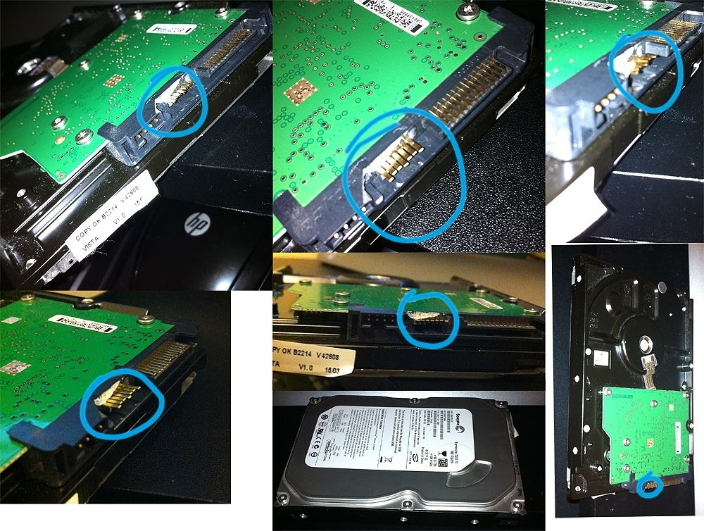

Hi i have a HDD with some very important Data on that im trying to recover.
The Data connecter is damaged the plastic peice is broken,
My computer was not working whenever i booted it would restart and keep looping.
so i gave the whole computer to a shop, then to a family friend to fix.
When they couldnt fix it i decided to look in to it my self and notice the Data connecter on the HDD was broken so one of them 2 must of damaged it :mad:
anyways i tried connected it to my current computer via the Data and power cables to the HDD but it was a bit weird putting the cable on to the data connector as there was no plastic peice as you can see on the picture.
It didnt recognise the HDD and didnt show up on My computer :(
is there any way around this? Could i replce that Data connecter peice?

I dont think you drive will work, the plastic peice on the drive only holds the cable in place and prevents you from installing the cable upside down, the data connection is still made with the sata cable 'pinching' the pads on the drives board.

I had the exact same happen to me and the drive is still running. I created a tiny shim and then glued the SATA cable and shim when contact was made with the HDD connectors. Every now and then it would pop out but still functions and applying some glue fixed it. It takes a bit of patience. If you have the original plastic then kudos as you are in luck as you can then crazy glue the plastic tab to the drive and then connect the SATA cable!

Right almost 2 years later i am back to finish the job, i have moved several times and took this little harddrive with me all the way hoping one day i can recover the memories. So anything new out ? or anything anyone can reccomend ? i was thinking of doing what the above guy said...
iam thinking of replacing the PCB but dont know which numbers to match to here are the numbers if anyone can give me a hand :D
on the PCB : 100439888 E F8112CXK
on the HDD sticker :
Seagate - Barracuda 7200.10 160GB
S/N: 6RA353JC
ST3160215AS
P/N: 9CY112-065
Firmware: 3.AAC
Data Code: 08123 Site Code: SU
STX-L3510
