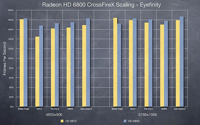

also dual 5870s or 6870s...is it like 2x the performance?

Some reading for TS:
ATI Radeon 6870 6850 - Featured Review - Widescreen Gaming Forum
Conclusions
The Radeon HD 6870 and HD 6850 are both excellent cards, and offer an amazing price/performance ratio. In my testing, the Radeon HD 6870 offered approximately 95% of the performance of the Radeon HD 5870, for 64% of the price - all with lower heat, noise and power.
The Radeon HD 6850 performed offered approximately 85% of the performance of the Radeon HD 5870, for 48% of ther price. The HD 6850 vs. HD 5850 comparison held ot that of the 6870/5870 - 95% of the power for 64% of the price.
The New Cost of Eyefinity
I year ago, the entry price for a high-end Eyefinity setup was $400 (or more, based on demand) for a Radeon HD 5870, and another $125 for an DP > Dual-Link DVI adapter. This was approaching $525 - just for the GPU. If you needed extra monitors, the cost went up significantly. Today, you can get a Radeon HD 6870 for $239, plus $25 for a DP > Single-Link DVI adapter. This puts you at less than $275 for what is essentially the same performance. Saving $250 on your GPU setup is a major improvement in affordability. That money could be put towards a CFX setup, the 3rd monitor, or left in your pocket.
