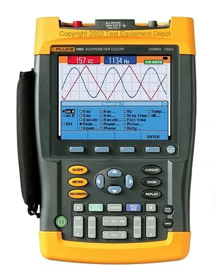

The electrical quality tester we had at my old job wasn't made by Fluke like the one I found, but some cheap company like MFJ. They were around $300, but that was 7-8 years ago. But anyways, the electrician you used to update your wiring, if it was done recently... maybe you could ask him to test the line for noise and proper grounding. The machine in question looks like this:
But I don't think you need to spend $2800 on such a beast. It can test for static, electrical noise, feedback, grounding and more. But any certified electrician really should have one and can test your main box and outlets with something like this and find out if electric is your problem in just a moment.
Adding additional grounding can't hurt, but it is still guess work unless you can get a reading. Your power supply is a good one, so I don't think you have a computer issue. Do you ever hear humming or buzzing in any speakers or devices in your house? If so, calling that electrician or borrowing a tester like that will be worth it. But if your computer is the only thing doing this, it is a strange problem indeed.
