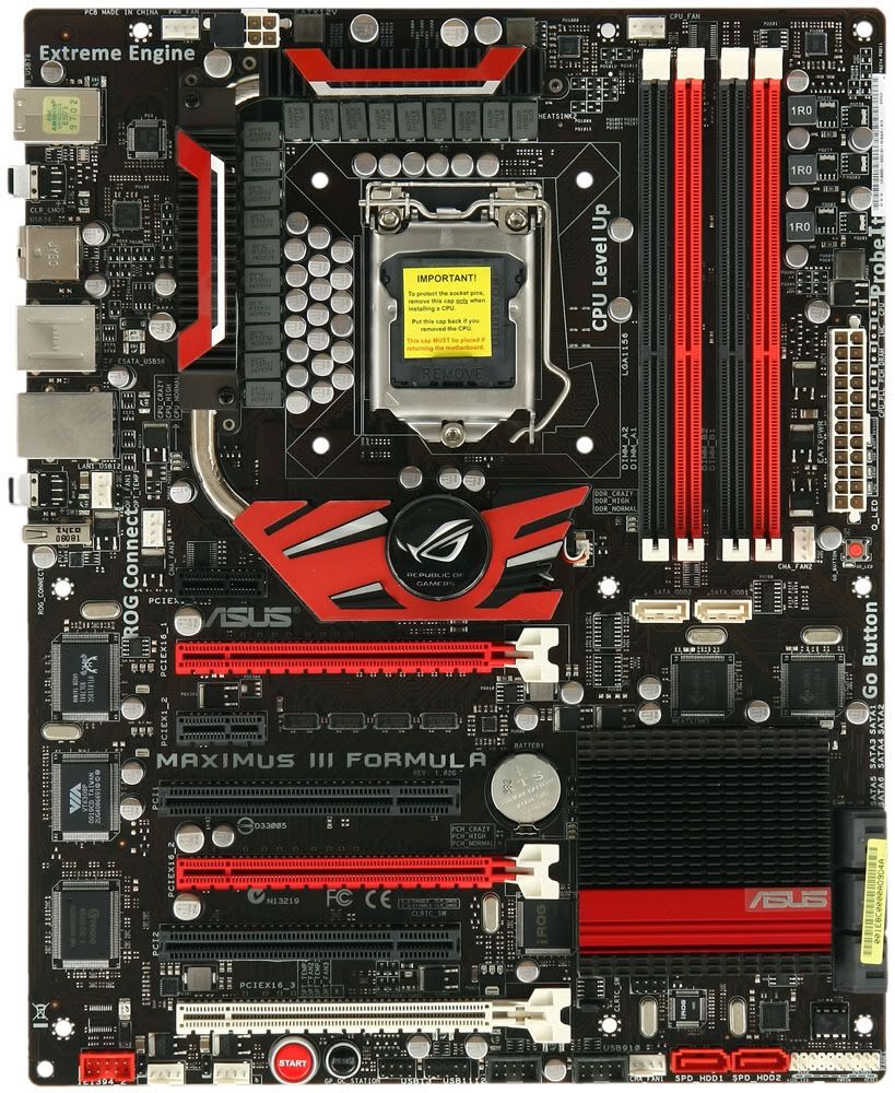

i said that cos on my Asus Maximus III Formula board i can't run 4GB dual channel rams in a2 b2 slots but in a1 b1 slots
