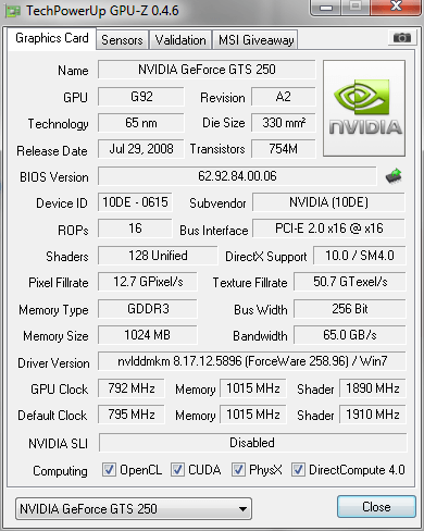

Screenshots with gpuz in them or it didn't happen. lol
So in the past 30 hours, you bricked one 250 ? Brought your whole computer to the shop and they put in a eco 250, you then exchanged that for a SC 250, flashed that bios. Now you removed your card and brought it to a friends house who happens to have a gts 450.

GTS250 SC:
I cant get the GTS 450 GPU-Z, maybe tommorow im going to my friends place tommorow.
