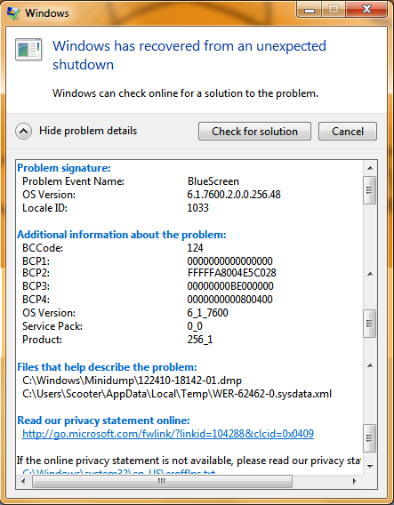

As of late I've been having trouble with my built PC. Randomly, the computer will shut down. First, the monitor goes black and says that there is no VGA connection, next the computer shuts off and reboots. After that, I open up the reliability report and the computer has no record of anything going wrong, but this puppy pops up:
The odd part is, is that no blue screen occurs, but that is what the error's event name is!

Check the ram in the bios, Volts , Timmings, and speed. Run a memetest over night. If you are OCing set the system back to stock.
Check for any wires that might not be fit tight.
Make sure your MOBO BI0s is up to date, and you have the latest drivers for it.
Make sure windows is up to date.
GPU, MOUSE, KB drivers are up to date and compatable for windows 7 ?
Sometimes i seen this when i was OCing and hade ( sleep mode on ) try turning off sleep mode if its on.
Check the system for heat issues and also for any virus.
Hope this helps
