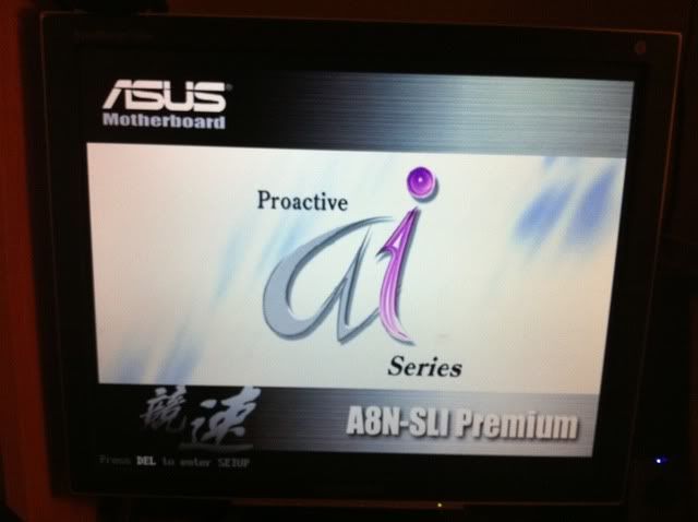

When I open my computer, this splash screen appears, which it has never done until a week ago.
It displays "Press DEL to enter SETUP"

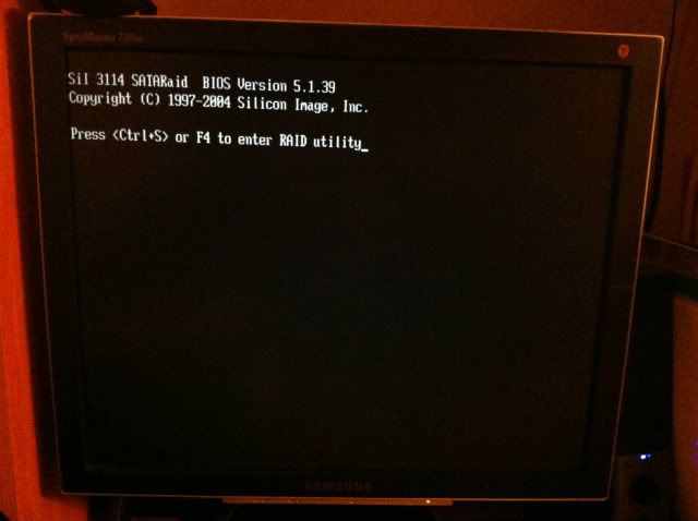

I let the splash screen disappear without pressing anything before I get the following:
I was unsure to what this problem was and pressed F1. Which lead to this finally screen coming up:

a b V Motherboard
December 9, 2011 6:44:44 PM
Could you give your full system specs? Raid is not something that you would have by default, you have to go out of your way to set one up.
When you changed the date & time, and exited BIOS, you DID take the "SAVE & Exit" option, right?
Looking at your screenshots, the second one shows that you have 1 optical drive and 1 SATA hard drive. You can only have a RAID setup if you have two or more hard drives, so you do NOT have a RAID array. That makes this simpler.

Unless you are still getting the CMOS Checksum error, ;you should be good to go.
There is an option in the BIOS that will prevent the first splash or LOGO screen from showing. Check the Boot Settings Configuration. If you disable the Full Screen Logo, you won't have the first screen anymore.
