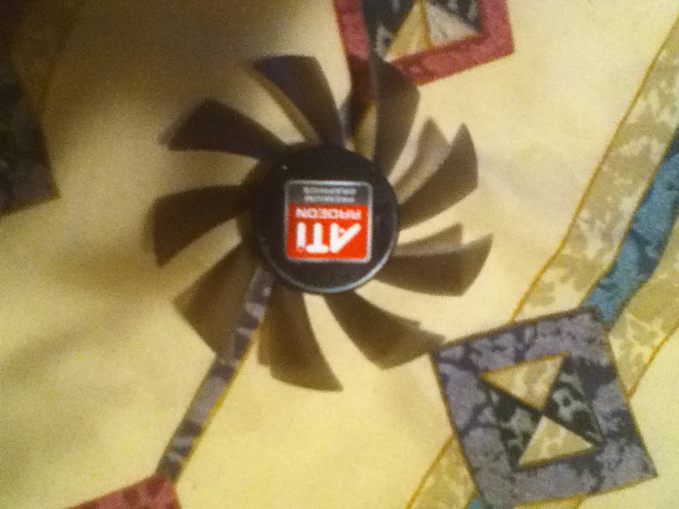

Did the fan break off or did the screws come loose? Also, do you have onboard video to hold you over for one more week? Either option (RMA or buying aftermarket) would take at least a week I'd guess. Could you take a picture of the part? The new cards should be out soon if you could go without the computer for a little while (about a week).

nope my board is ASUS Rampage 3 Formula that doesnt come with an onboard video unfort. The screws i guess came off, fan is still in one piece its just not connected to my video card atm. I can post a pic. Give me few minutes

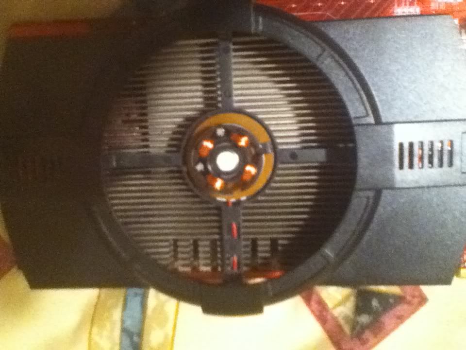

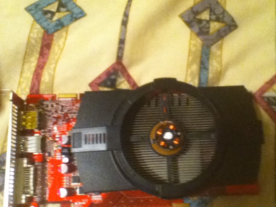

a b U Graphics card
December 8, 2010 2:55:12 AM
Hmm, the pics are a little blurry, but it looks like the center shaft broke. Does that look possible when you look at it (such as rough surfaces)?

a b U Graphics card
December 8, 2010 2:56:41 AM
I assume pushing it back into place doesn't help, right? It may also be a design without a center shaft, though a center shaft is the way I normally see that type of fan made.

December 8, 2010 3:06:37 AM
well when i put the fan on it will stay on but its really wobbly and when i put it back in my computer and tried running it the fan doesnt move at all. Its really funny though, how the heck could the fan break for no reason. Oh and sorry about the blurry pics, used my ipod to take em lol. As for the center shaft no it doesnt look broken, when i look at the fan seems like it was attached with some sort of glue that dried out now?

a b U Graphics card
December 8, 2010 3:07:49 AM
In looking at the pics looks like the plastic shaft broke off and the top part is still attached to the fan or you might be right that it was glued on - IS there a screw attached to the center of the fan under the label ? -- might be easiest to just replace the heatsink\cooler with an aftermarket one instead of trying to replace the fan as it looks to be problematic getting it attached and centered so it will not wobble.

a b U Graphics card
December 8, 2010 3:41:59 AM
If the shaft isn't broken then the plastic retainer inside the fan motor likely is. I broke one of these on a case fan and I can still use it (because the fan is vertical). Unfortunately, graphics cards have upside down fans, so if this component (or the bearing or bushing) fails, then you probably have to replace the fan. You *might* be able to use a spare/cheap case fan to tide you over until you can get a new card, or you can RMA this one.
