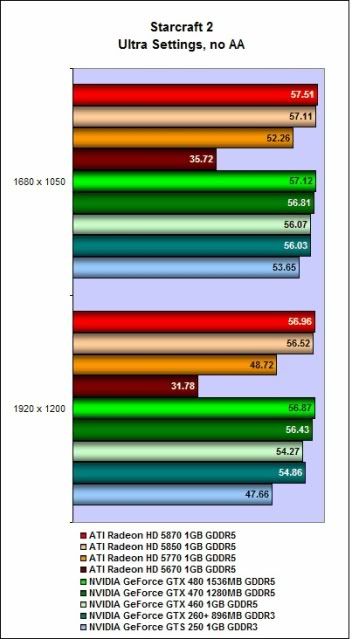

That depends - the peeps at Hardwarezone did a multiplayer SC2 GPU test
Ultra with no AA
Even up to 1920 x 1200 one may argue a HD 5670 is playable but yes 5770/GTS 450 is more than fine

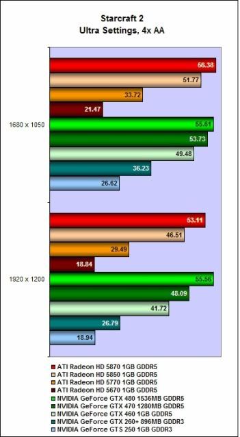

Ultra +4AA
You'd be looking at HD 5850/GTX 460
As a lifetime Blizzard gamer though my $0.02
Blizzard games unlike Crysis, etc are not about eyecandy - i play these games due to it's enjoyable/addictive *gameplay* so no thank you for escalating costs just to turn up AA SC2 nuts can't tell the diff anyways :lol: :lol: :lol:
