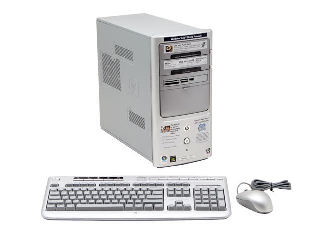

I have an HP Pavilion A1730N. Everything is still OEM, and I will be installing a new GeForce card in it. With the card, I need a new PSU. The new PSU (TOPOWER Galaxis GAPS-500MX) has a 140mm fan in the top. The case for this comp has no vent in the top for a PSU fan in that position. (SEE PICTURES BELOW)
Is it better to have the 140mm fan on the PSU (the big one) pointing out the top of the case with access to fresh air, or will it be acceptable to install it upside-down and have the fan pulling air from inside the case? (SEE PICTURES BELOW)
EDIT: This is the fan I'm talking about: the huge 140mm one inside the top of the PSU.
New PSU:
OEM Case External (PSU Mounts in the top rear):
OEM Case Internal:

    Ok, the 'green' fan you see on that picture, should be facing inside the case
    its sucks air from inside the case and exhausts it from the grill at the rear, you meantion mounting it upside down, the original picture you posted, that psu IS upsidedown in relation as to how you would mount it in your case,
    and as Ghnader says, we need to know your intended graphics card before suggesting a suitable rated psu,
