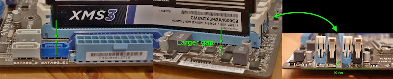

On further investigation I have found that the memory sockets are actually bowed.
To illustrate this I have placed a memory chip in the socket so you can see how the middle of the memory is actually lower in the socket than at the ends. This problem does explain why the memory chips can rock in the socket.
I also found that the memory sockets are not soldered to the mobo all the way to their stops which means these boards have been produced with a fault.
I will post a photo of the solder error soon.
Posted here now is a photo of the bow in the sockets.
Asus%2520P8P67%2520LE%2520memory%2520slot%2520bowed%2520in%2520centre%2520causing%2520memory%2520movement%252019-02-2012%25209-48-17%2520PM%2520800x531.jpg
Wow, good catch. It is not done properly at all. It is easy to tel from the pic.
Well, replacement is a must here! Hard to believe that it actually passes the quality check.

Further example why your computer could Freeze while in the middle of use.
Note two things in this photo
1. The Memory socket is not soldered to the motherboard and leaves a change in height. This will affect memory functionality and reliability
2. Looking at the right hand side of the picture which is the end of this bank of memory slots note how the first slot is off the motherboard as mentioned earlier and that the next blue slot is actually on an angle! Poor quality control most likely due to the rush to get the updated Sandybridge boards out.
asus%2520joined%2520memory%2520socket%2520on%2520motherboard%252019-02-2012%252011-23-16%2520PM%25202257x1393001.jpg
Added image separately to help see the memory sockets clearly
Asus%2520mobo%2520memory%2520slots%2520with%2520poor%2520quality%2520installation%2520and%2520quality%2520control%252020-02-2012%25207-10-38%2520PM%25201500x618.jpg

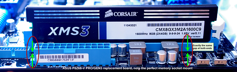

On a closing note here is a photo of my new mobos memory sockets the way they should be.
While quietly hopeful l won't have any further problems l'll just wait until l have the new one running for while and let you know.
