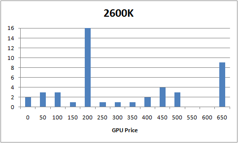

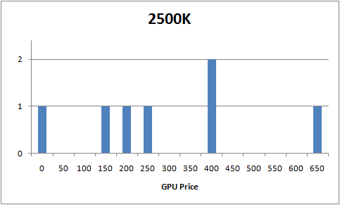

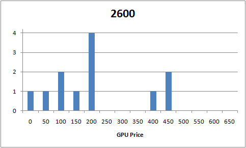

Maybe better results came from computers in which better parts went in overall. I don't have very much information about the computers these cpu's were in, or how much OC'ing was done, so the best I can really do is a histogram of GPU's based on price (widely varying ages and some being professional made comparing benchmarks unreasonable).
I'm going to assume that more expensive GPU's not only would do better against cheaper GPU's but also correspond to the other parts of the computer being better.
A price of 0 means something like "VNC Mirror Driver" was written in the GPU column.
With the exception of the 2500 (non K) all histograms are scaled to have the same total area filled in with bars, so height corresponds to percent in a comparable sense.
Here are the histograms:
Note that for the i7-2600K the expensive graphics card, the ATI FirePro V7800 (FireGL) corresponded to the best results where on the i5-2500K it corresponded to very mixed results (even though the guy who used it in the 2500K was kind enough to write in that he OC'd his to 4.6 GHz.
These histograms do seem like enough to imply that the 2500K's were on average put into better computer's than the 2500 and explain the huge differences in benchmarks. They also explain the large spreads on the 2600K benchmarks.
It looks like on average the 2600 (k or not) isn't better by enough to buy it and large spreads from average seem to be explained by GPU.
