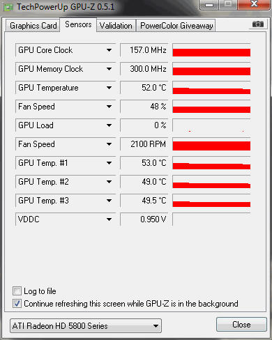

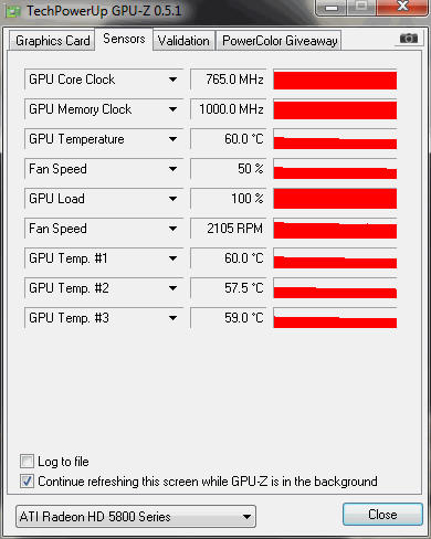

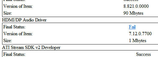

OK. Using the trick, here are my observations:
1) I still have the HDMI/DP Audio install failure. :??:
2) My framerates did stay the same rather than get a lot worse. :)
3) New problem has arisen after a session of MOH... Observing each card in GPUz...While GPU1 acts normally with minimal activity in Windows, GPU2 is pegged at 100%GPU activity(???), and GPU3 goes idle (as expected). :o
GPU2 is still showing 100% activity in GPUz. So I guess now I have the CPU@100% issue that others have mentioned.
Images following play:
GPU1 ("blips" of activity)-
GPU2 (pegged at 100% usage)-
GPU3 (idle as expected) -
I had just finished playing when I took the images. Framerates on MOH right around 140 average. Even now, GPU-z is showing GPU2 at 100% load. The fan is spinning 2krpm+. Nuts.

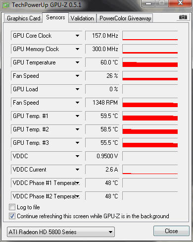

February 22, 2011 12:50:52 AM
GPU2 after a session of MOH on 11.1a drivers:
GPU2 gears down afterward. Back to "normal".

February 26, 2011 12:30:38 PM
Rolled back to 10.10(again). It's been 4 months since I revert back to 10.10 because of 3 main reasons
1)No way to disable Catalyst AI
2)99% GPU usage even in 2D mode
3)In 11.2, my 2D speeds are 400/1000(which should be 157/300) resulting in higher idle temps.
