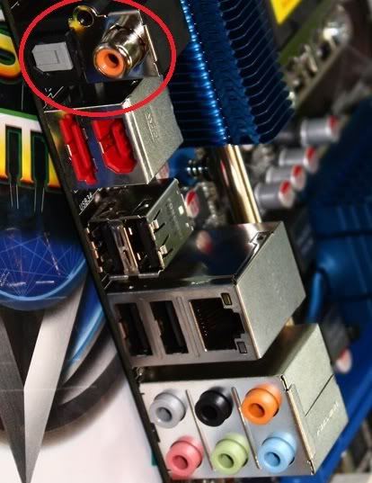

What is the sound chip on your motherboard? I don't know where you read that the PC only outputs stereo - that's not been the case for years. I have had surround sound on my motherboards for a long time now.
They typically offer optical and/or coax digital output, which should be all you need.
Or you can configure the sound as 5.1 (in the sound configuration utility), and use (typically) three sockets on the back of the motherboard: one for front left/right, one for surround left/right, and one for sub and centre channel; you'd plug in three cables that went from 3.5mm plugs to a pair of RCAs each, and use the 5.1 input on the amp (assuming your amp has a 5.1 input; not all do).
If you have a really old (or really low end) motherboard, then it's possible that you do only have stereo output, and then yes, you'd need a sound card.
My current builds all have 7.1 sound (which can be configured as 5.1 or 2.1, or even more exotic setups) on the motherboard.

Yes your right i just looked at the back of my computer my mother it is the ASUS P6T SE i only purchased it 7months ago. it does have an optical and coaxial outputs . does that mean i can connect my surround sound via my optical output, and it will just configure into 5.1 sound via windows 7 which i already have. here is a pic of my motherboard, it has optical on the left and spdif coaxial on the right.
so what you think ?
http://i156.photobucket.com/albums/t25/nahas22/OPTICALCOAXIAL.jpg
Thanks.
