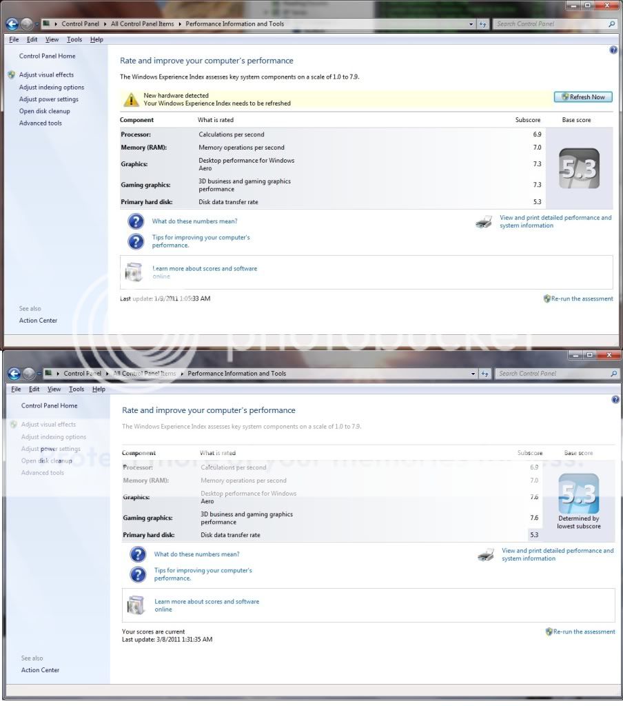

Those WEI screen shots, which is which?
Also you can try running 3DMark11 or some other games to see if performance is ok. Maybe BC2 is just being dumb?

Hello.
The top screen is from my older 5770 card, the one below which shows slight (??) improvement is with the new 6870. All hardware and video settings are exactly the same except for the slightly highet W PSU. Everything else is unmolested.
