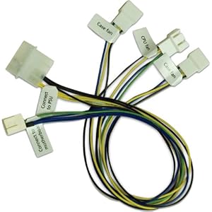

This is the best way to control your 2nd fan with one of these.
Akasa AK-CB002 PWM splitter - smart fan cable

Cheers uther. Defo worth a try. Placed my order for the cable to give it a try. Cheers.
