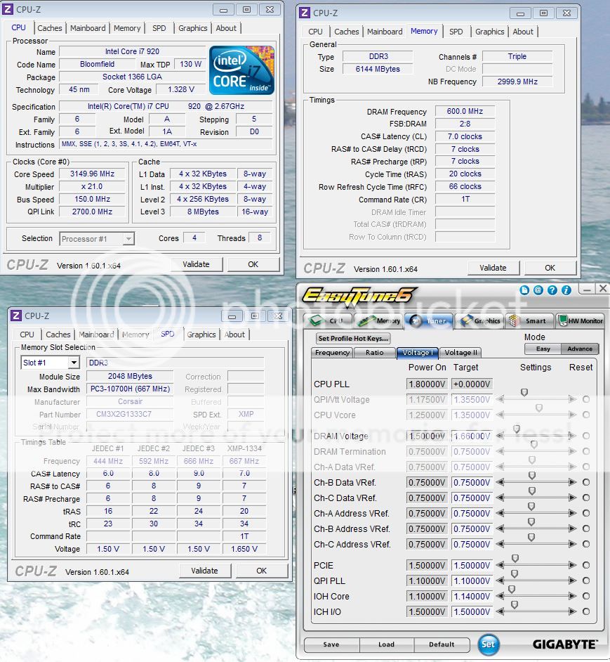

Some CPU-Z info can be found in the next screenshot:![]()
I've updated my bios and switched some values around but the speed doesnt change in AMD system monitor.

The memory is fine, DDR stands for DOUBLE DATA RATE, So the number displayed is HALF the frequency that the memory is actually running. The frequency 600Mhz is actually (1200Mhz), 667 for (1333Mhz), 800 for (1600Mhz) Etc.
Also to consider. Despite the fact your ram might also by stock be clocked at 1333Mhz You might want to double check your FSB-DRAM multiplier in your bios and clock your ram to its full 1333Mhz Because from your photo reference your ram is actually running at 800Mhz.
May I ask also if you have overclocked your processor because this will impact the FSB of your ram, Not only your processor.
