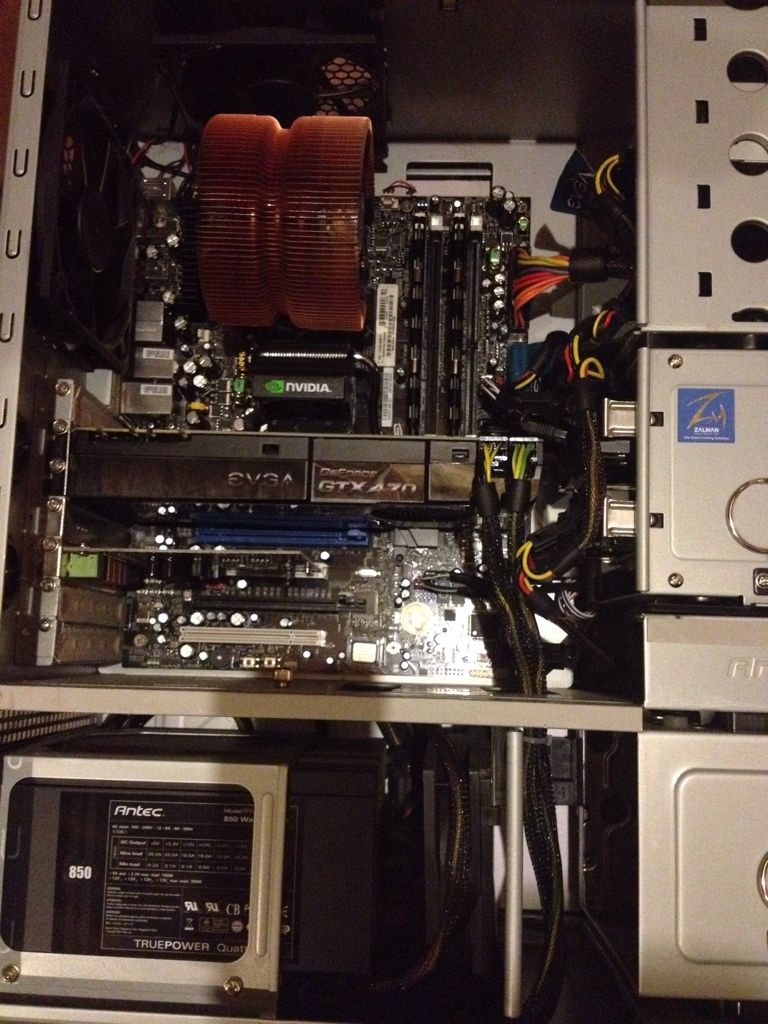

Not really relevant but heres my cirrent cpu that has been running perfect for several years.

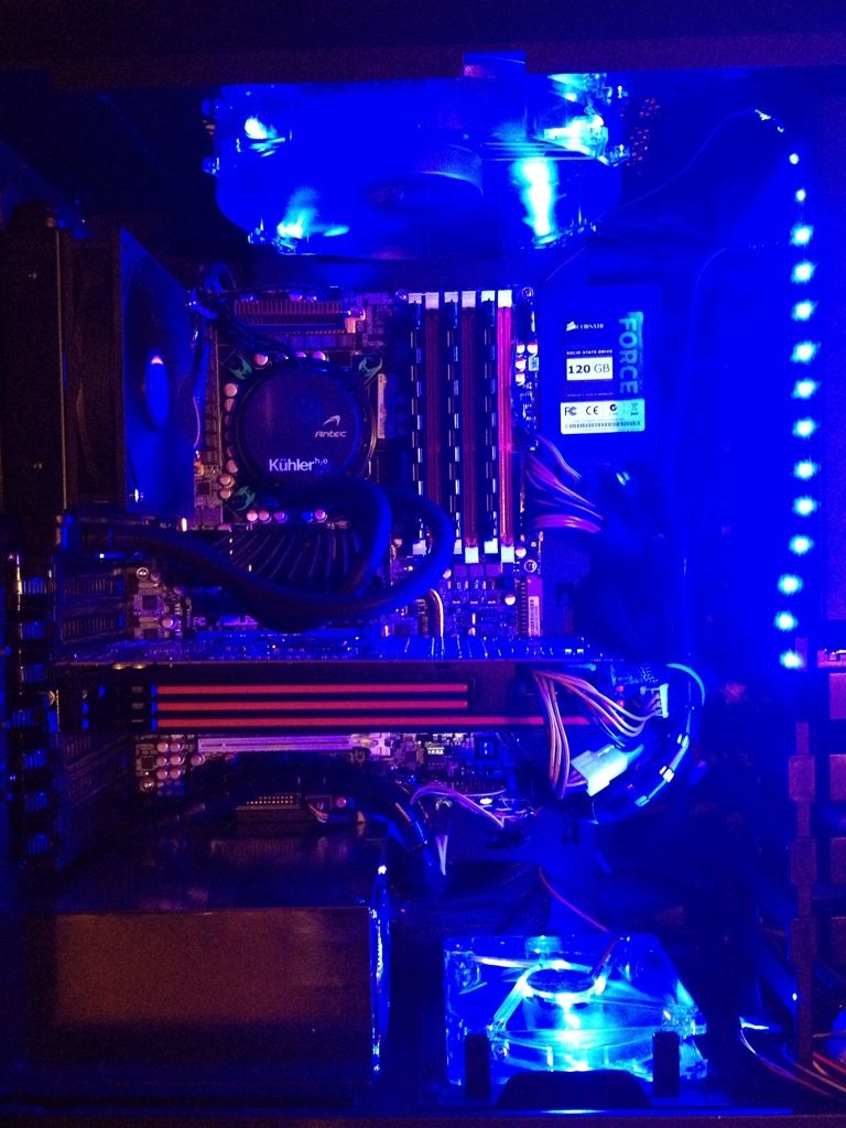

here is the desktop in question powered on. My old mobo has a n lcd error display i wish this one did.
Ive never had issues with my pcs ive usually spent tons of time during assembly triple checking etc and theyve always booted up so this has kin dof got me stumped at where to begin or diagnose before dissassembling the entire thing.
