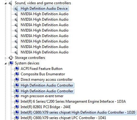

i dont have the PCIe Sound Card yet.. im using the on board sound card.. i can see under your sound video and game controllers, your speaker is named as High Definition Audio Device, and the rest is NVIDIA High Definition Audio.. mine is named as Realtek High Definition Audio if im not mistaken.. and the rest is High Definition Audio Device.. ok so, after i uninstalled these and rebooted, should i install the one from the ASUS site? or the one from Realtek?
and i see under the Sound Playback.. your speaker icon has check, my speaker icon is like your ATI HDMI output, it says not plugged in. and the default speaker its giving me is the Realtek Digital Output(optical)..

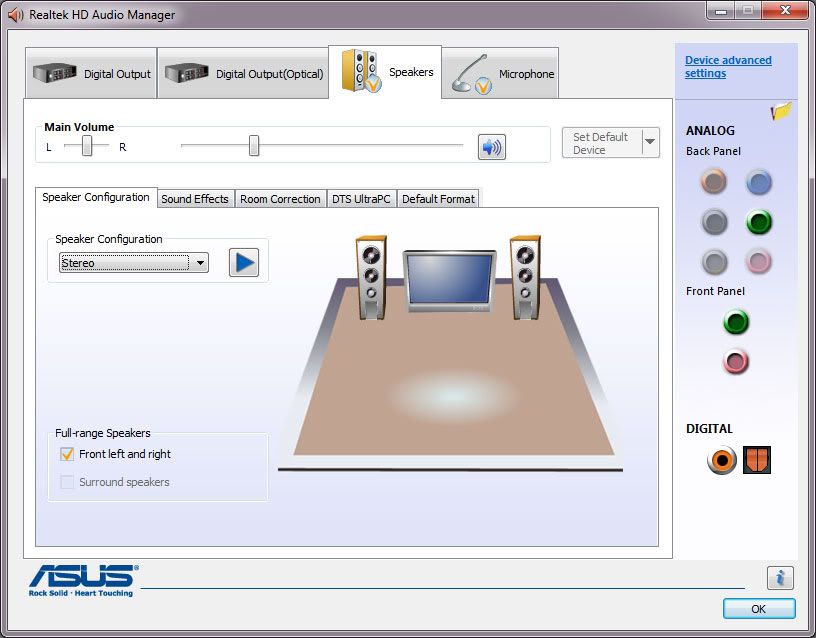

in the realtek hd audio manager, under analog back panel.. the icons are disabled.. mean unlike yours the color green is enabled and the rest disabled. but in my part, everything is disabled. im sure to post the screen shots later.. coz im still at the office..

I deliberately did NOT install the Realtek drivers; too many issues and bloat. The 'High Definition Audio Device' is Windows Default -- no problems! ;)  In my case I have two very good USB headsets.
Those images are from two different systems, top X79 and bottom (2) my X58 (both ASUS). On the X79 it has Headphones (not plugged-in) instead of ATI.
I posted those because the ideas are the same.
IF it were me I'd uninstall the Realtek (programs), (Device Manager / Stereo, video ...) 'Realtek High Definition Audio' Uninstall & bottom -> [x] delete the driver software and reboot. Once you have the ports working then create a Restore Point then either the latest from ASUS or 'the' latest from Realtek for your OS/bit size.
