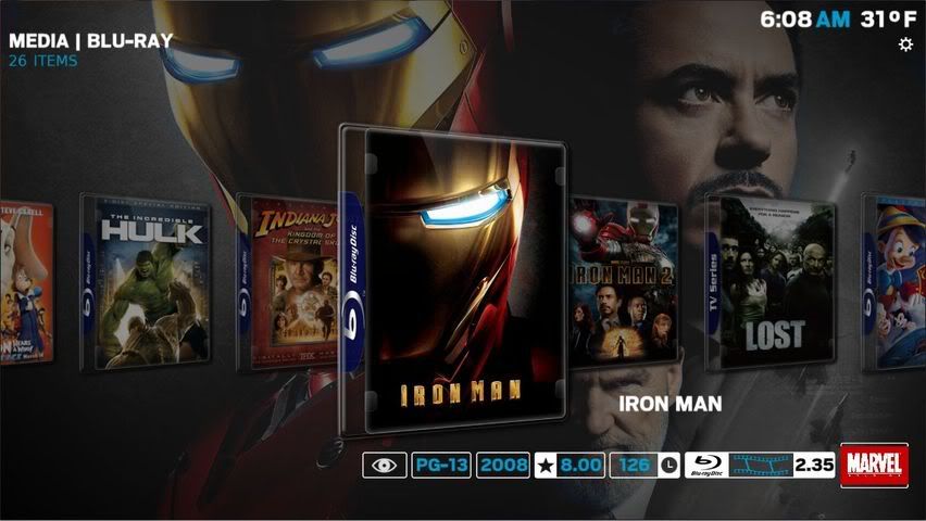

Also, with your father's 200 disc changer... I think you should introduce him to Media Browser. All the discs can be stored on the hard drive and he can access them through WMC:
It's very customizable and pretty slick looking.
