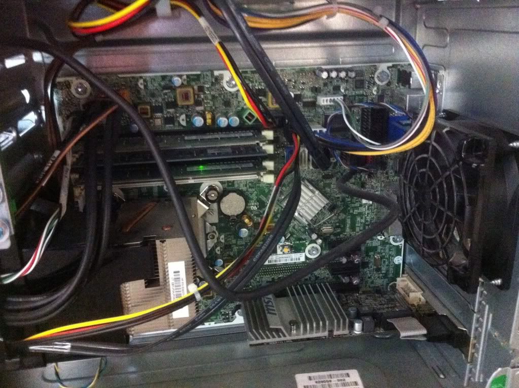

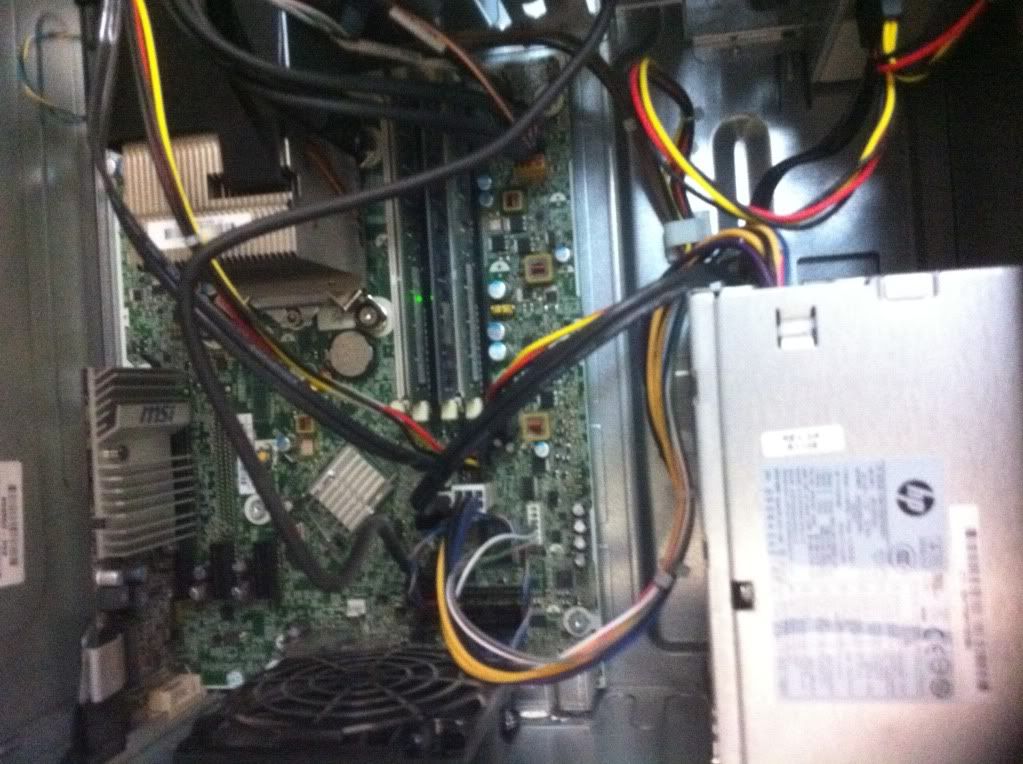

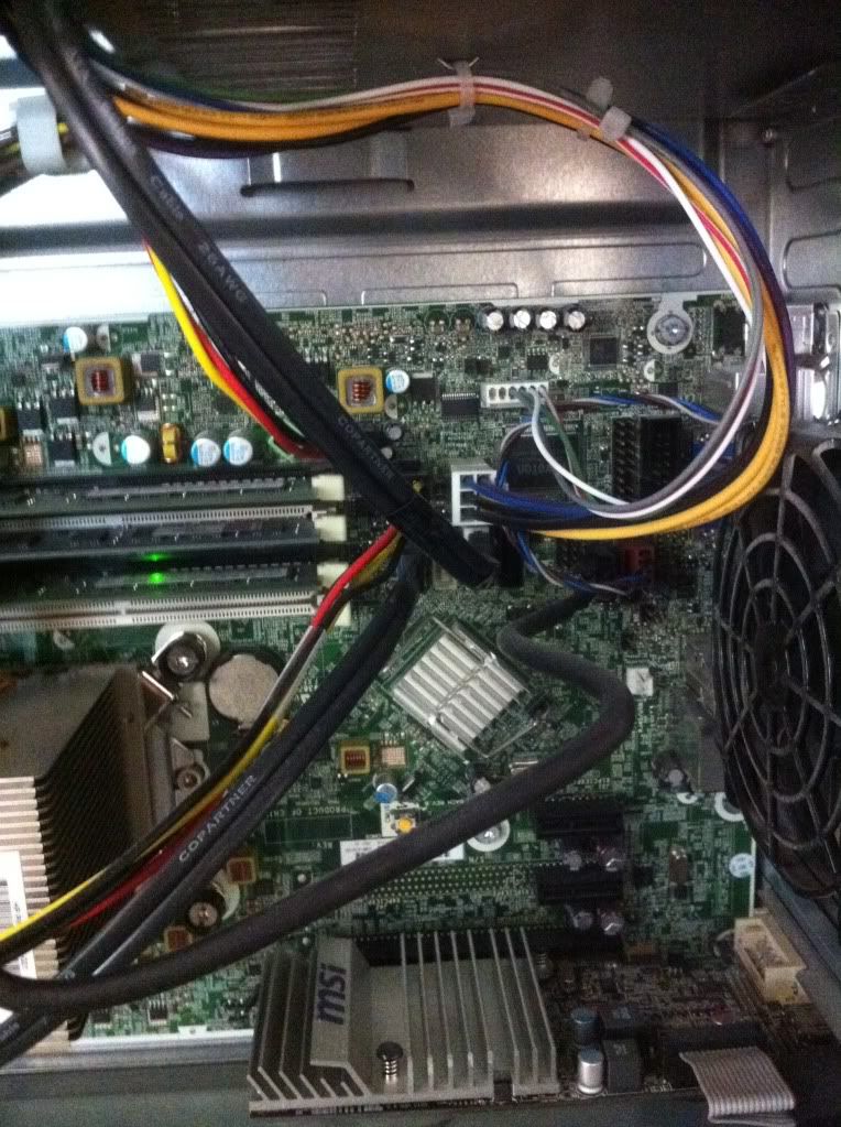

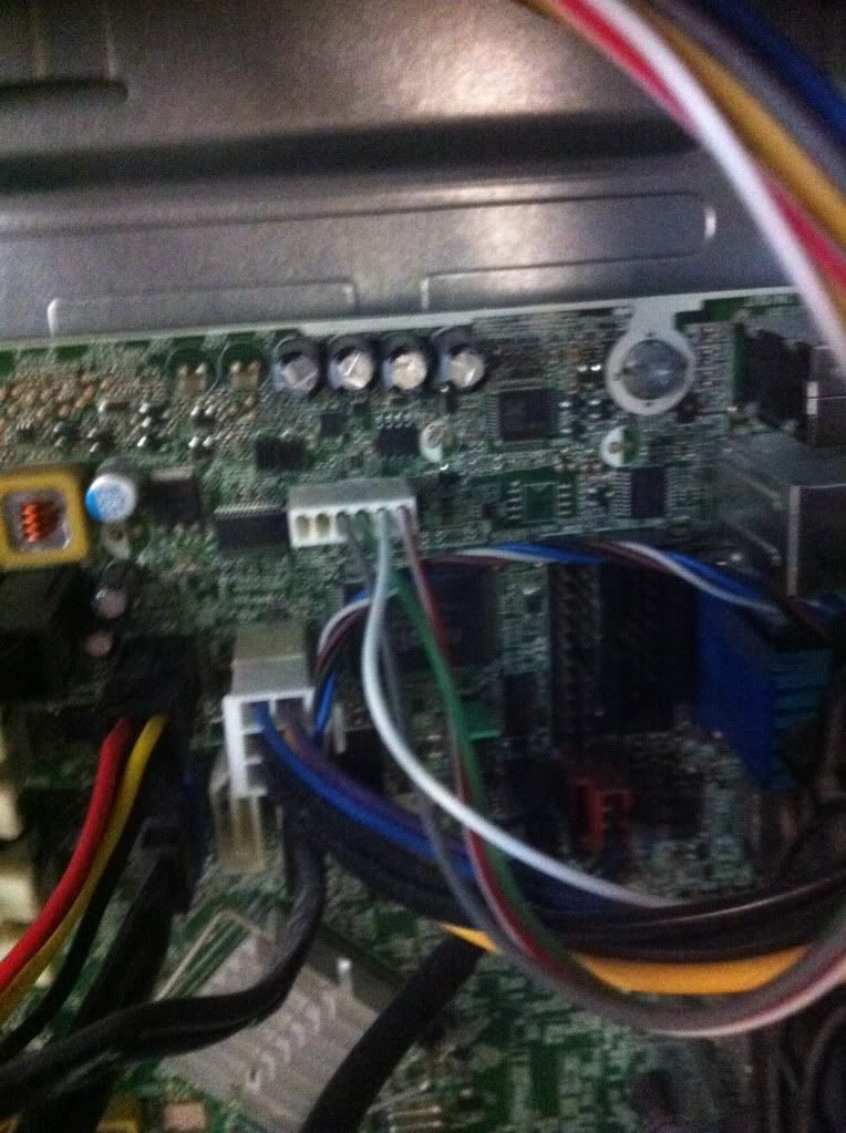

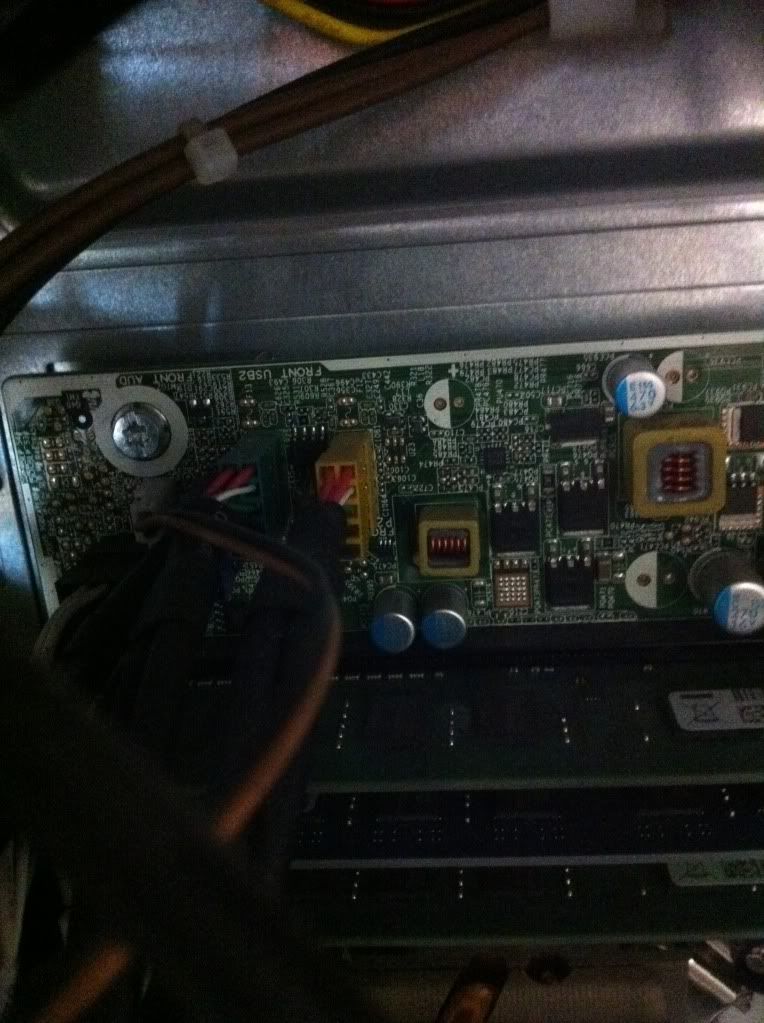

If you look at those specs you should be able to locate the MotherBoard i own, basically in it i dont see any white 24/20pin connector for my new PSU to go into? The current PSU goes like to some other connectors and then weirdly the motherboard connects to the hard drive and stuff instead of the PSU doing it?

Can you take a picture of your mainboard? You should have a 20/24 pin and atleast one 4 pin power connector. Look closely at your mainboard as not all board have the connector white I have seen a few that where black or grey.
It could also be that HP is using a custom board and you will need to get a PSU from them to work.
I'm nearly sure the motherboard isn't listed there as a model, it's most likely a custom board made by hp to fit in such a small case, though I might be wrong.
That configuration of wires sounds very specific to your pc, you're probably best off posting pictures of how the wires look.
Your PC has a proprietary motherboard that doesn't use the standard 20/24 pin connector. You will have to buy a replacement power supply from HP. Take a look at this illustrated manual:

Yupe, your motherboard doesn't have any 20/24 pins. Guess you have to buy a replacement from HP or worse, you have to change your motherboard.
